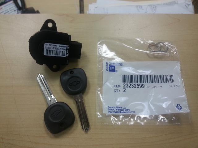

The Ignition Switch Recall includes the parts shown below, PLUS a new key cylinder. All of these recall parts are ordered based on the cars VIN number.
Parts in the kit include: new ignition switch, 2 new keys, 2 key rings and the key cylinder(not pictured but included)
