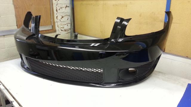

More real SS parts for my fake SS
My local Chevy dealer loves me. Here is the SS front bumper cover fresh from the paint booth

Old 01-31-2014, 09:24 AM
  #106
XtremeSS's Avatar
Join Date: 02-13-2010
Location: HuskerNation
Posts: 698
nice touch! the SS front end is sexy!

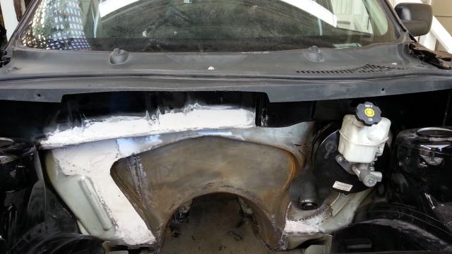

2 full days...a little progress
I just finished 2 full days of work on the car, really doesn't look much different. As I posted before, I had to cut out the bottom of the passenger side of the fresh air intake/rain trough to clear the right cylinder head. Well making a piece of sheetmetal to fit in the hole was a job. Fortunately I have a really good (Lazze) bead roller and shrinker/stretchers. Even so, it took several tries to get the part correct and even longer to weld it back in place. Welding down inside that trough is really hard. Oh well, it's done and the cowl is back on. And wouldn't you know it, you can't see anything I did.
