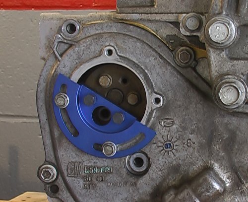

This is the proper tool that 843 is reffering to, you can grab one about $30. I have changed the water pump on an ecotec in under 5 min using this tool (yes, engine was OUT of the vehicle).
When the engine is in the vehicle, it is a little more difficult to access. I had a problem very similar to yours, after lots and lots of time and energy, finally discovered that the previous owner had used radiator stop leak and managed to plug up the heater core. We took one of the little 1 foot long heater hoses and bent it over and attached it back onto both barbed fittings coming from the thermostat housing. This made the car run normal, just no heater. You can read it here Anywho be sure to kill the engine if it hits 225° or you gonna warp the head, blow the head gasket or possibly warp the block. I advise you to take this little overheating issue very serious. I live in Dallas where it gets really hot, on the hottest of days with A/C blowing, I never see engine temp go over 205°. Winter months, no A/C it actually can hit 210°. For the most part my temp runs 188 - 198°. I have a 2008 2.2L, 2009 2.4L and a 2008 SS 2.0L.
