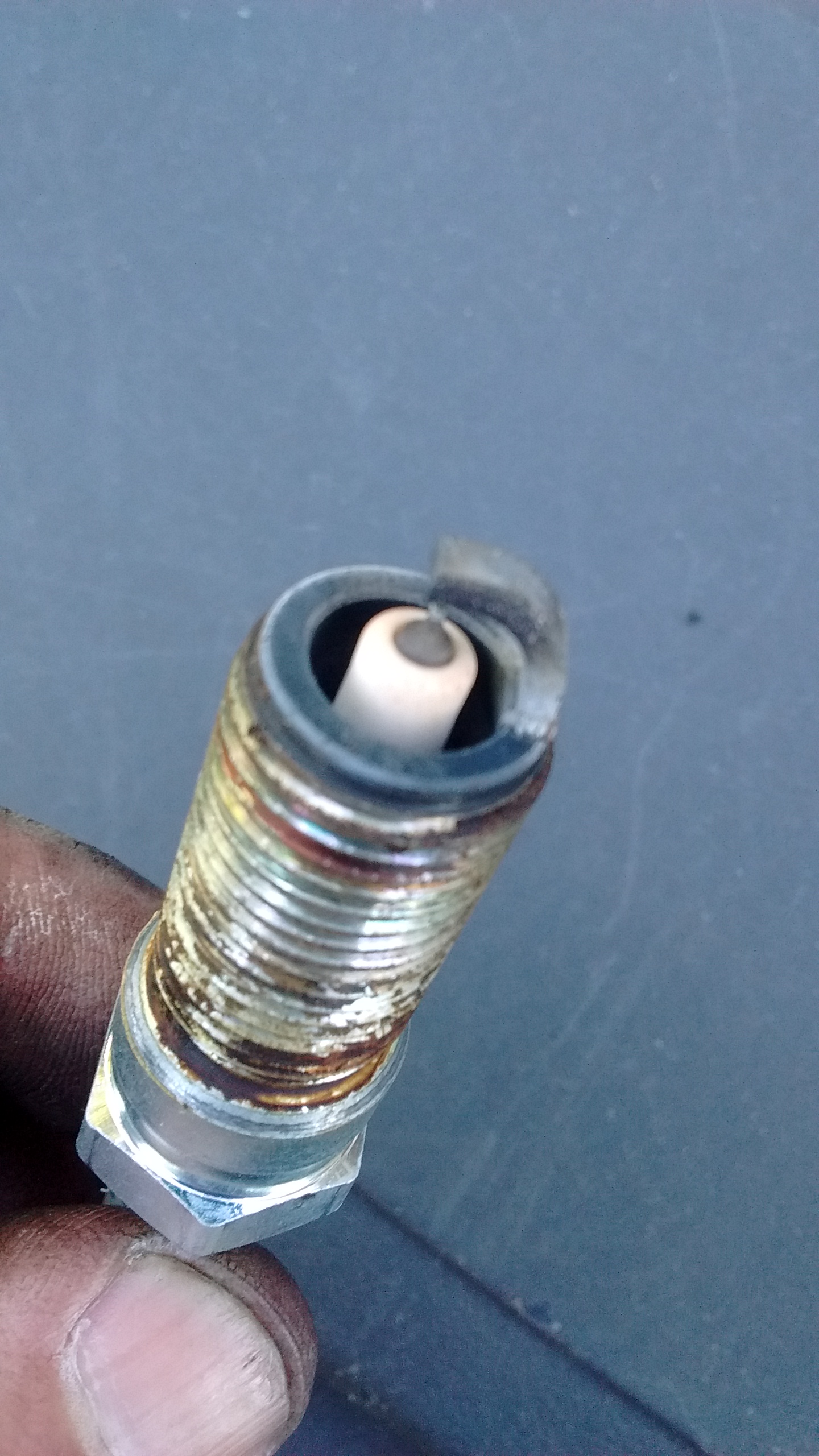

I've run a can of seafoam through the gas tank, and nothing but shell premium for about 1500 miles. I also replaced fuel injector #4. I also pulled the #4 sparkplug to see what it looked like.
The problem has only gotten worse, with the service ESC light on 90% of the time, and the check engine light on continuously now. The only thing that made the light go off was when I removed the old plug to inspect it. When I put it back together, all of the warning lights went off for about 250 miles. But they came back on about 1k ago, worse than before.

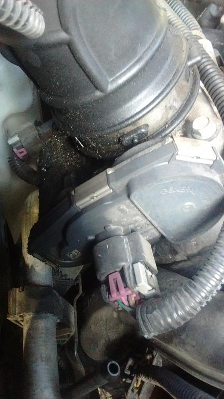

I also noticed a little bit of oily crud above a sensor at the front center of the vehicle. The sensor is in the general vicinity of the hood latch. I am not sure which sensor it is, or the source of the oil. It wasn't much but it hasn't been there in the past.

I maybe way off-base, but that plug looks like it is running a bit lean - OLDLUE, what's your take on it?

I concur, that looks lean
That oil thingy is your throttle body, be careful and clean it with TB cleaner
At the electrical harness check those wires for a loose connection clean that connection
Slather some dielectric grease on it.
Check and clean your MAF sensor with the correct cleaner and check those pins
