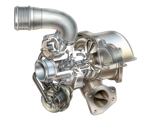

OK, let me see if I have this correct now. The BPV is actuated by a vacuum created in the intake manifold when you let off the throttle via a vacuum line which allows over pressure in the cold pipe, prior to the throttle plate, to be released back into the exhaust stream. The diagrams I have looked at make it look like it is vented into the hot pipe but from what I've read it's the exhaust.. Cool pics attached. I assumed that it was a pressure relief valve similar to the ones we use at work that are "pushed" open not "pulled". Now that I have one to look at it makes more sense.
[IMG][/IMG]
Full size image links:
http://i41.photobucket.com/albums/e2...ech20Turbo.jpg
