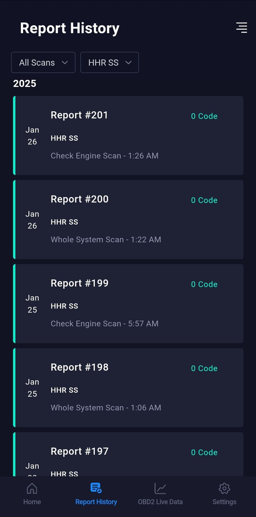

I have scanned my SS = NO CODES, & the CHECK ENGINE LIGHT is not on...
