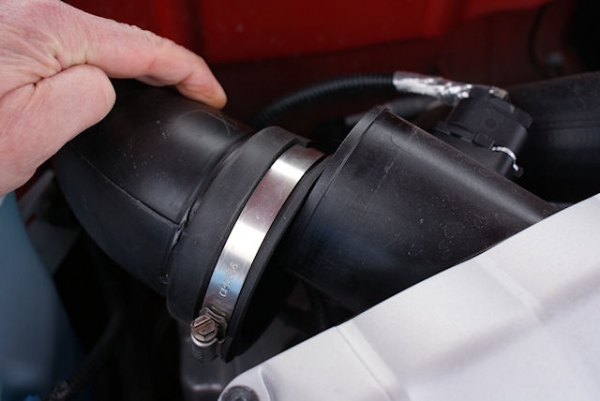

Posts: 2,358
From: Fairport Harbor, OH
Spring Installation Pictorial Essay
I don't know why I let you guys talk me into these things...
Especially with no pictures.
First, locate the general target area:
Then loosen the air pipe. Sort-of. Not sure if this helped or not.
Now you can see the cap on the BOV. That off-white plastic thing in the center of the picture. If that isn't it, then I eff'd up big time:
Twenty minutes later, (i'm only halfway there) I have the old spring out and compare it to the new one (right). It's a smidgen (CH) shorter and a bunch stiffer.
I put it in the plunger/diaphram thingy:
Then it goes back into the cap, but needs to be held together just as reported while you re-assemble it:
And after another 20 minutes and scraped up forearms later, It's done. No report on the effects, if any. That will come later. I did check around the block to make sure no toxic fluids were spewing out or red lights flashing. So far so good. BTW, as difficult as it was for me, I don't think I used any of my choice words I reserve for working on the car, (or boat).
