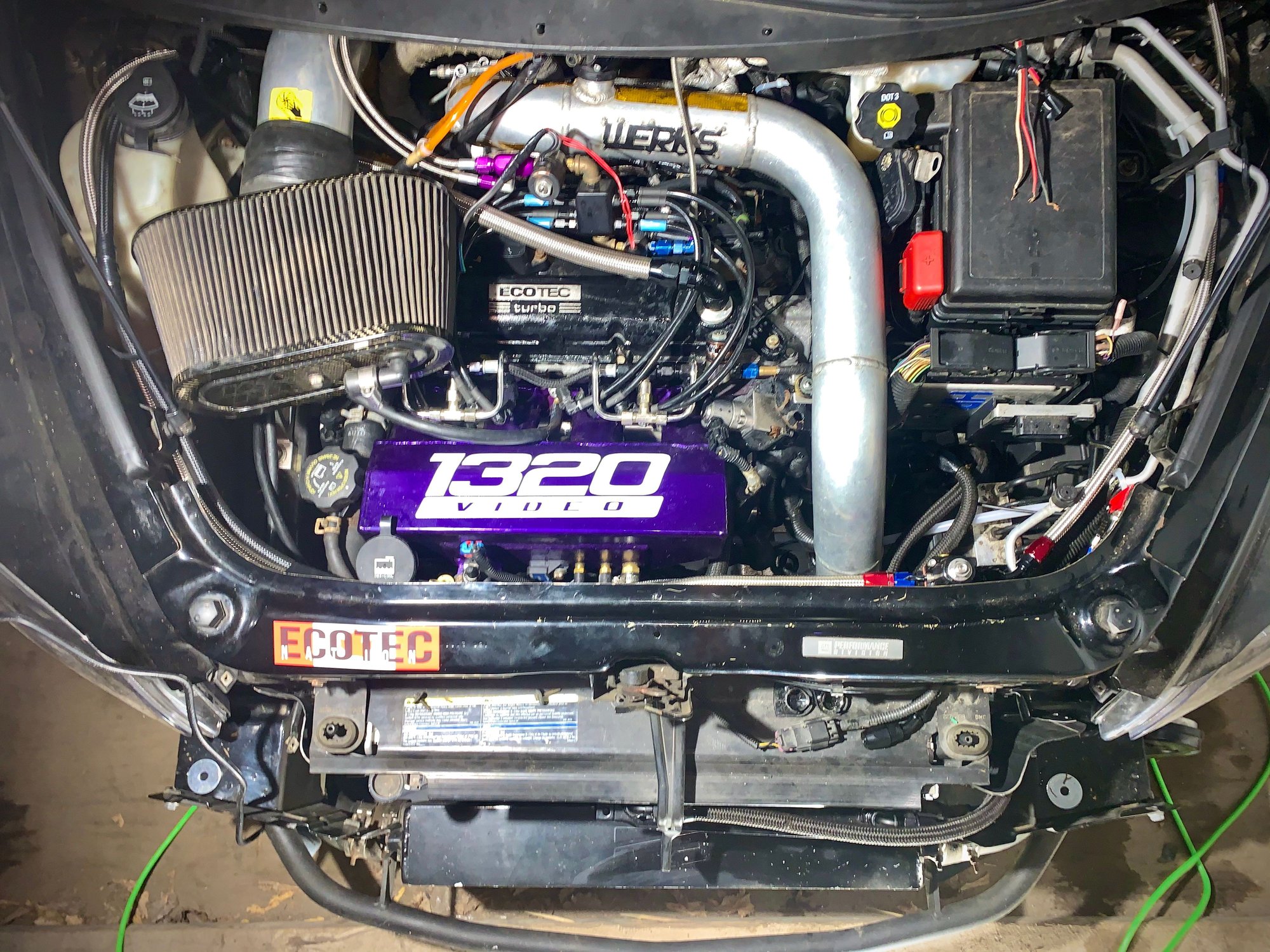

Just have to finish wiring the nitrous/auxillary fuel setup and tap the manifold. Looking like it’ll be done shortly. Hopefully the stock sleeves and my F23 dont mind😂

It’s looking good! How much of a spray are you adding?
starting with a 68 shot, if it responds well I’ll use 100

Ah, good , give it more spray in small increments. What rubber compound you have for slicks?

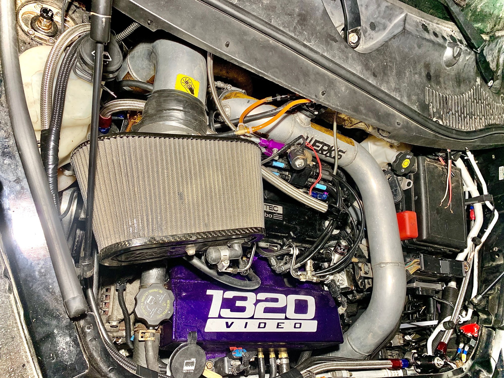

might want to get that CAI out of the engine bay and pipe it into the fender or front end, pulling hot engine compartment air will rob you on some combustion.
it has a tray under it now with dei heat tape, theres heat tape on the valve cover too, but it doesnt matter that much honestly. My intake temps at the maf are lower than ambient even with the methanol off. Theres no other good place to put it either, i might run a turbo guard 3.5” filter. Hard to find and im not even sure if theres enough room for one
