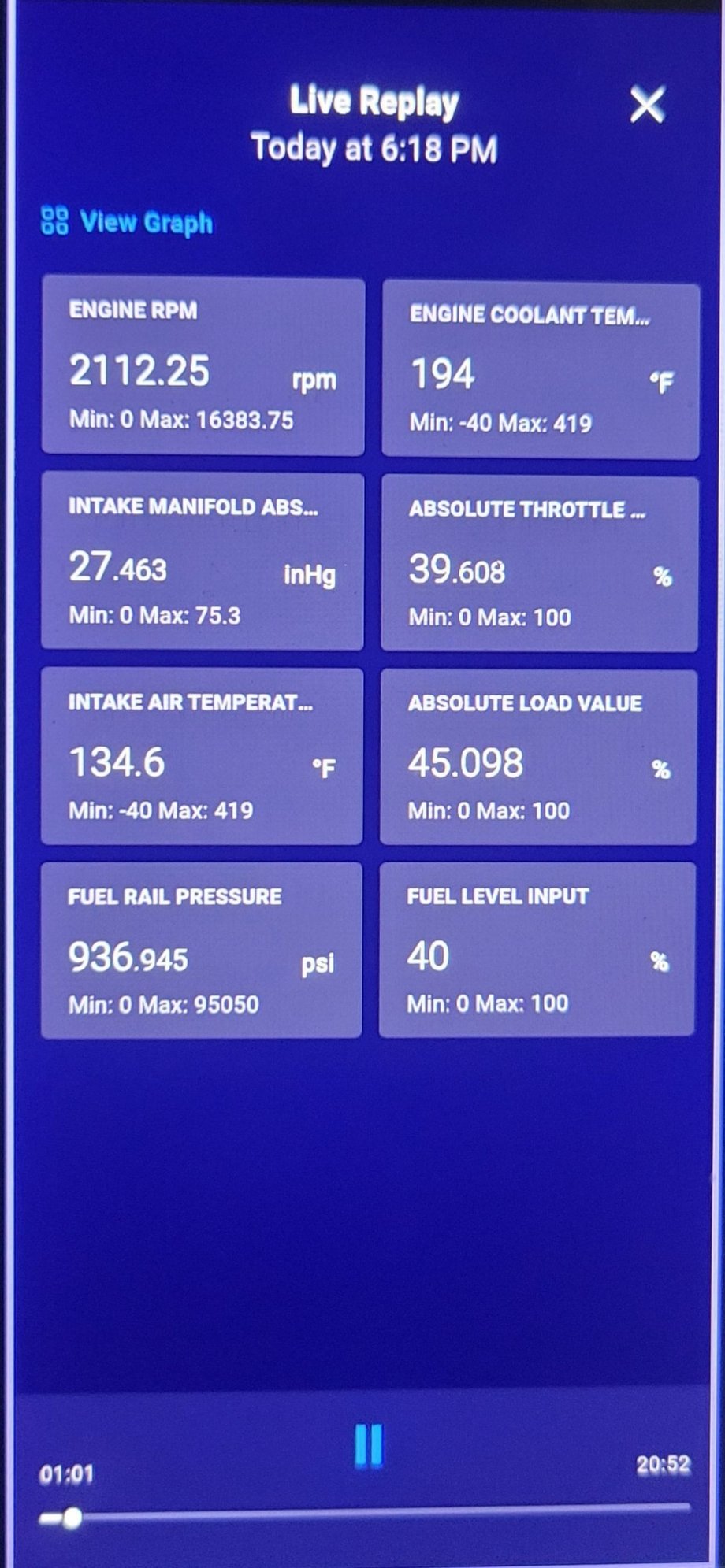

Couldn't download the video to my tablet = just a still picture of the LIVE DATA drive. So far, the #'s stay within their normal range/s = but I'm still learning about all this...
let me know if anything looks off to you guys???

I think I only get up to 20 InHg vacuum, even when the engine was new. And while I don't know what the IAT is supposed to be, but that seems high. Is your homemade CAI actually bringing in cold air from outside of the engine bay? Most aftermarket intakes do not.

Intake air temp. You’re sucking hot air into the intake. The stock breather assembly will keep the air intake temps within 0-7 degrees of the outside ambient air. Cooler the better.
Guess your backyard cold air intake ain’t working.

Trial & error = I can easily swap the OEM EQUIPMENT back...

Where the original hard plastic tubing went from the box to a factory hole right above the motor mount = that's where I installed the tubing & was able to fit the air filter comfortably spaced = not just crammed in there...
