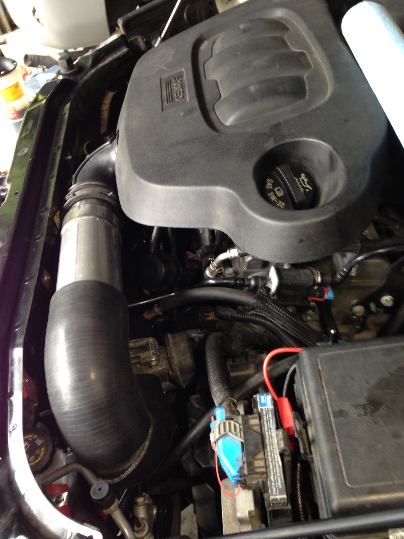

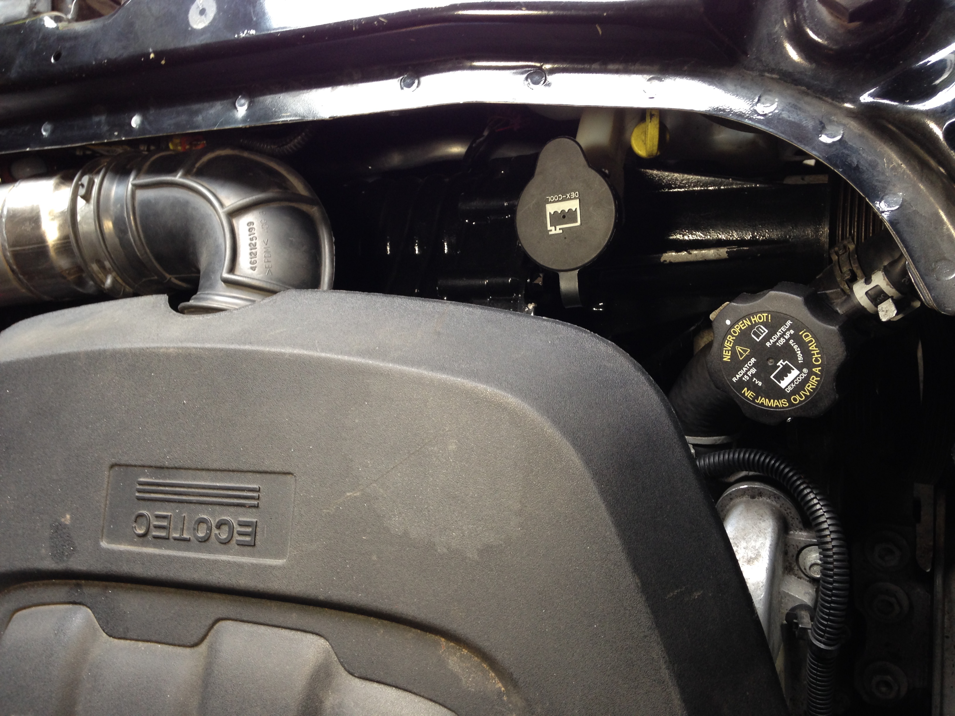

Here's a shot of my wifes "sewer pipe" intake. Flows more air but definitely at a hotter temp. I've got the upgraded intercooler but my IAT is normally 10 degrees above ambient. I do plan on designing something that brings cold air in. It's a huge downfall on the ZZP turbo upgrade kit.
This is what I'm tiring to illustrate, the hot under hood air is not optimal for best combustion

What about piping to the outside of the engine bay to the area behind the head lamp and mount the air filter under the headlamp behind the fog light? Other than the bends in the hose slowing down the airflow? Possibly sucking water and road dirt into the filter and clogging it faster it might work?
Naw I still think the stock air box works best on these wee beasty's
Stock air filter flows just fine. Ive got a vacuum gauge on the air filter box and under full throttle it reads 0. The stock air filter will flow more air than you think. With the stock intercooler normally I see 10 degrees under ambient air temp after supercharger depending if the water meth is turned on. Look close the m-62 is hiding under there.

ZZP's claim is that the upgraded intercooler makes up the difference. Obviously not, not @ 10* above ambient. I really need to feed it with outside air properly. I have no idea what the ZZP tune looks like, I'm sure it still uses IAT to determine available timing. HP tuners is on the back burner until I get its other problems sorted out. DP needs refabbed and my lower charge pipe needs cut to length.

Which IAT were you looking at when you seen 10 above ambient? We have 2.

I'm not sure which IAT I'm seeing, I have my cheap little scanner for live data now. I will check what the scanner is actually calling the PID. Either way, colder is better! I'm probably going to remove some metal next to the headlight and build an airbox up there. Pretty much wide open. I'd like to build an inlet on the fender but that's up to the ol' lady!
