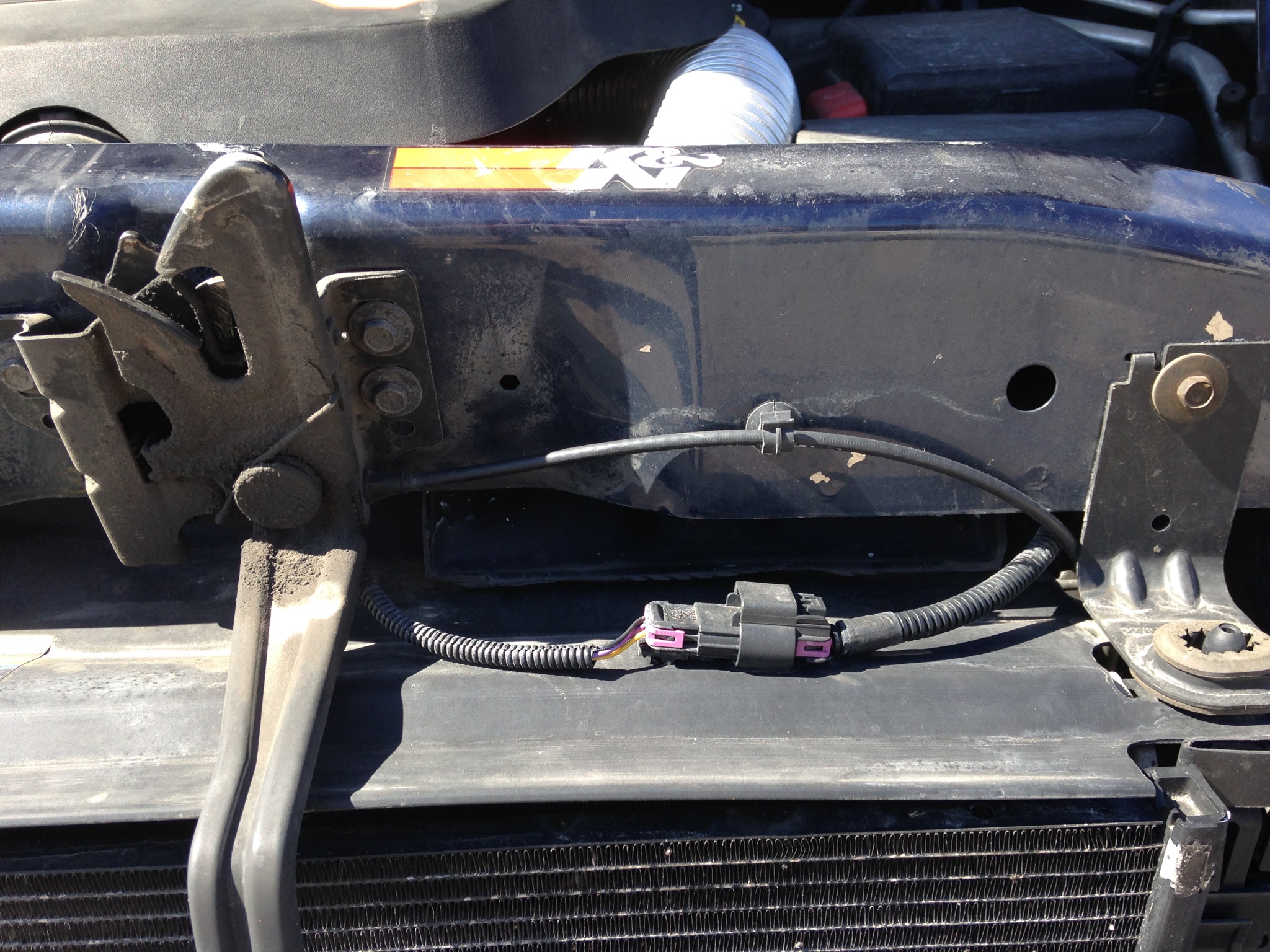

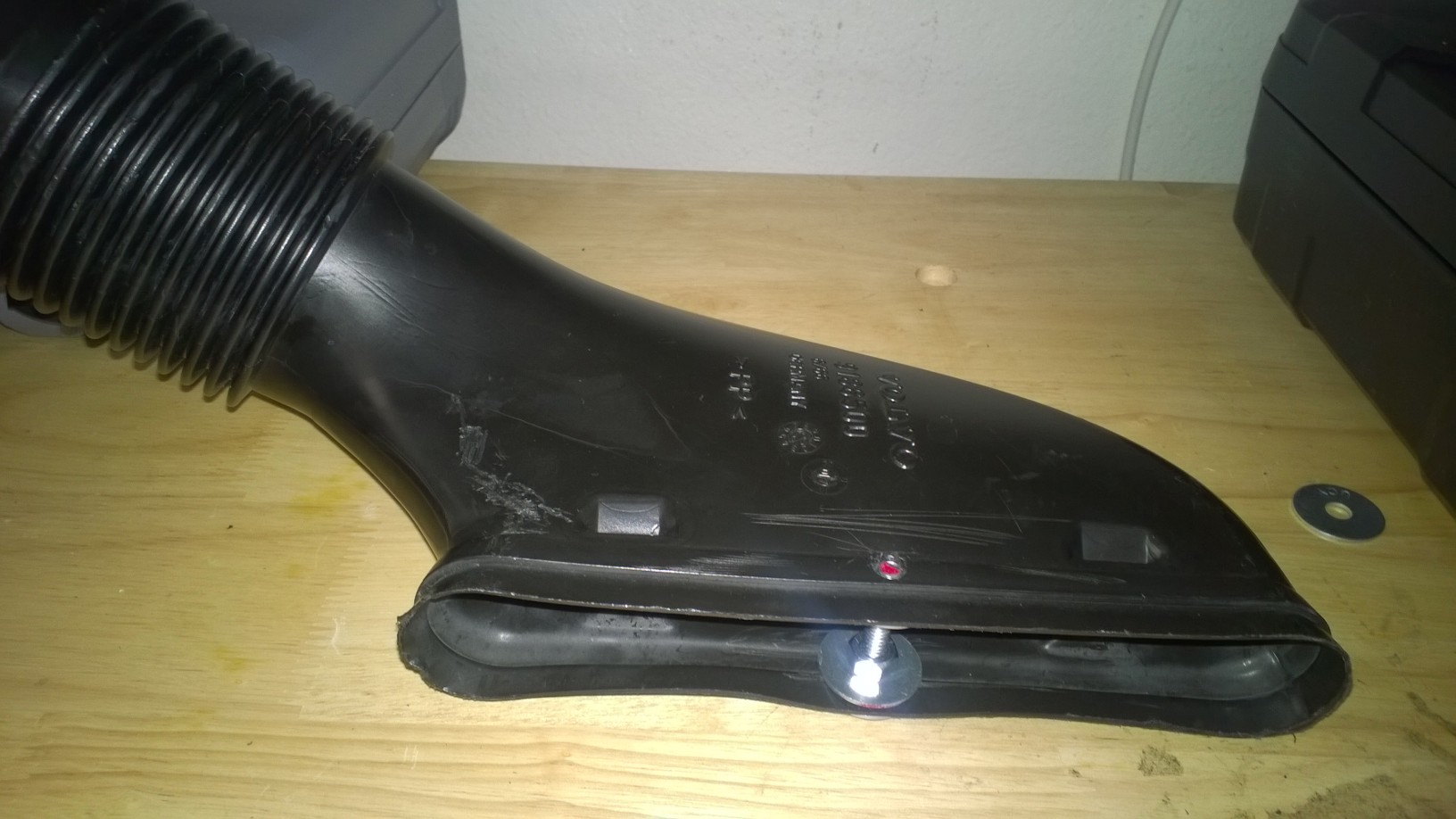

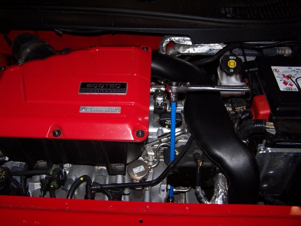

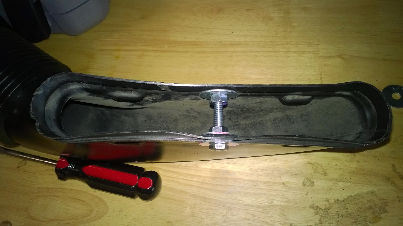

Originally Posted by Dbeluscak
Here's a shot of my wifes "sewer pipe" intake. Flows more air but definitely at a hotter temp. I've got the upgraded intercooler but my IAT is normally 10 degrees above ambient. I do plan on designing something that brings cold air in. It's a huge downfall on the ZZP turbo upgrade kit.
This pipe fits perfect between hood latch metal frame and radiator allowing cold fresh ram air volume with the OEM air box worked great on my ss it did help and did ad lil

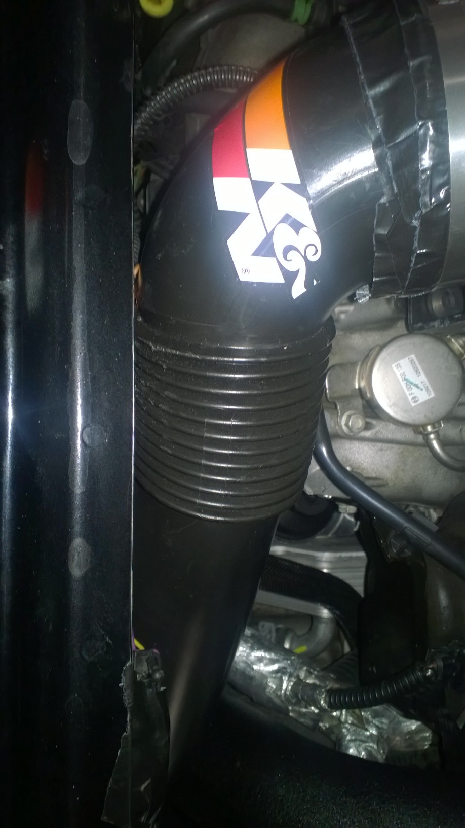

Are We being Tricked by Vendors & Cold Air Packages-image.jpegGee that K&N tube is just like my set up.
But I got the idea from other members on this sight
Did you have to cut a hole for that in your stock air box on the SS?
