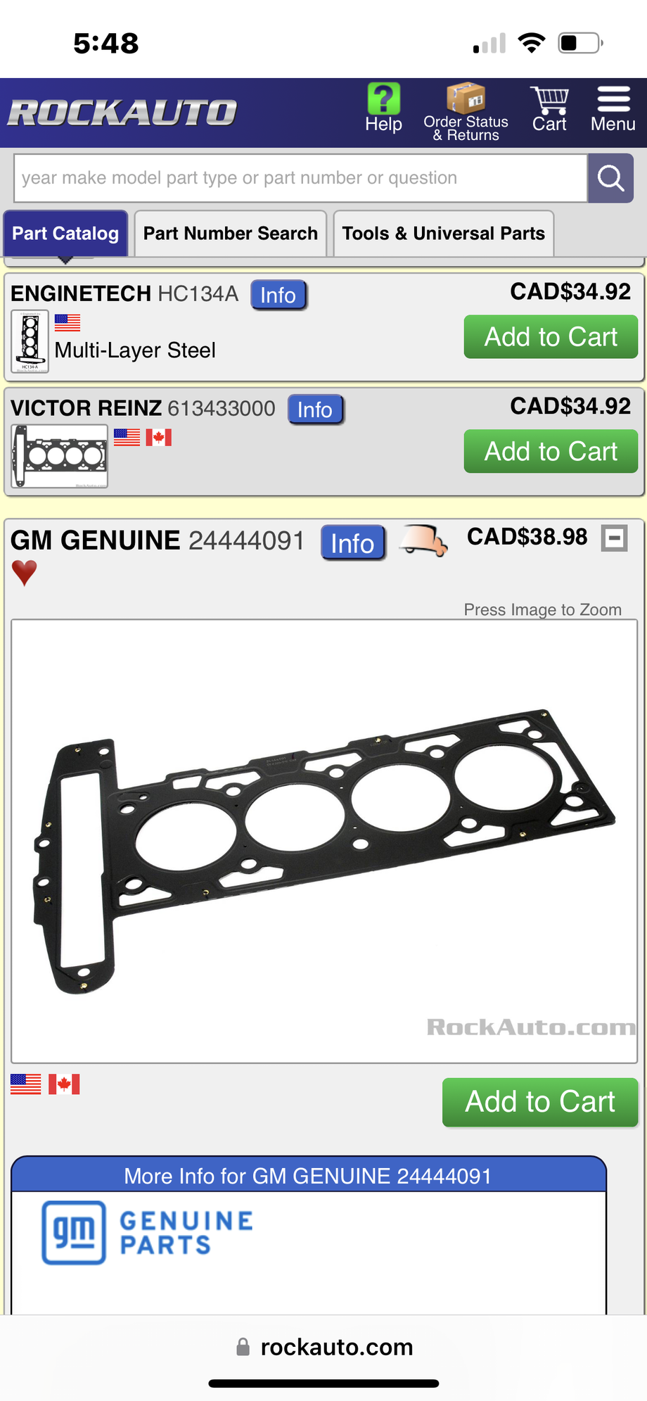

Old Aug 23, 2023 | 04:51 PM
Posts: 40,082
Heads aren’t interchangeable head gasket won’t line up.
