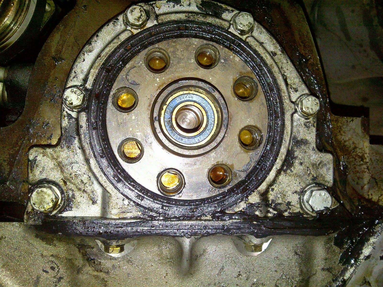

Rear main seal lives on the left side of the engine If your sitting in the driver’s seat.
Front crankshaft seal is #426
if you mean in the left side looking from the front bumper
