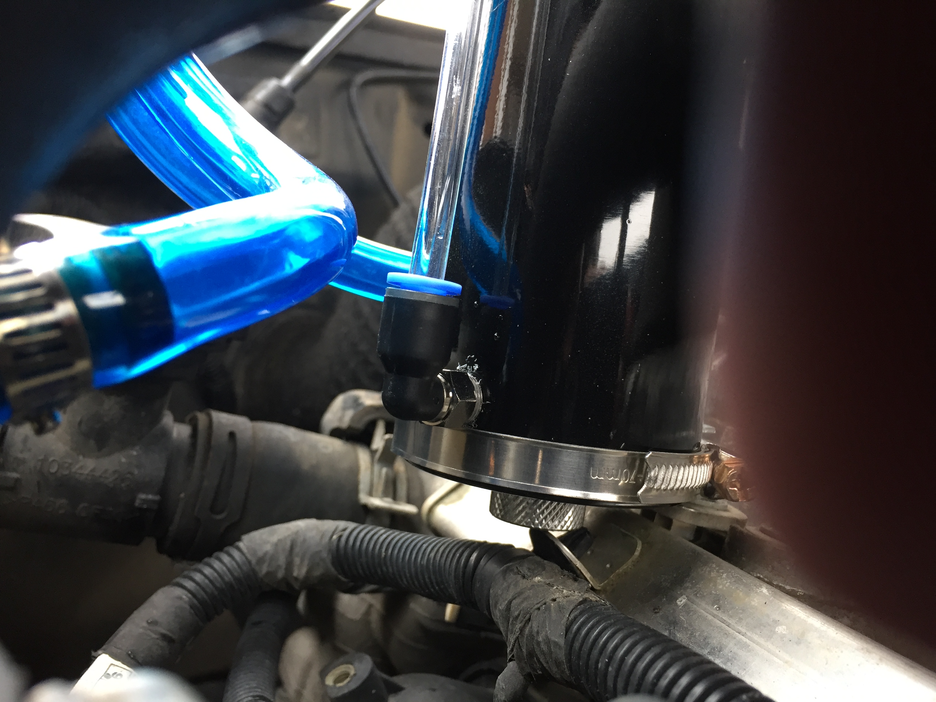

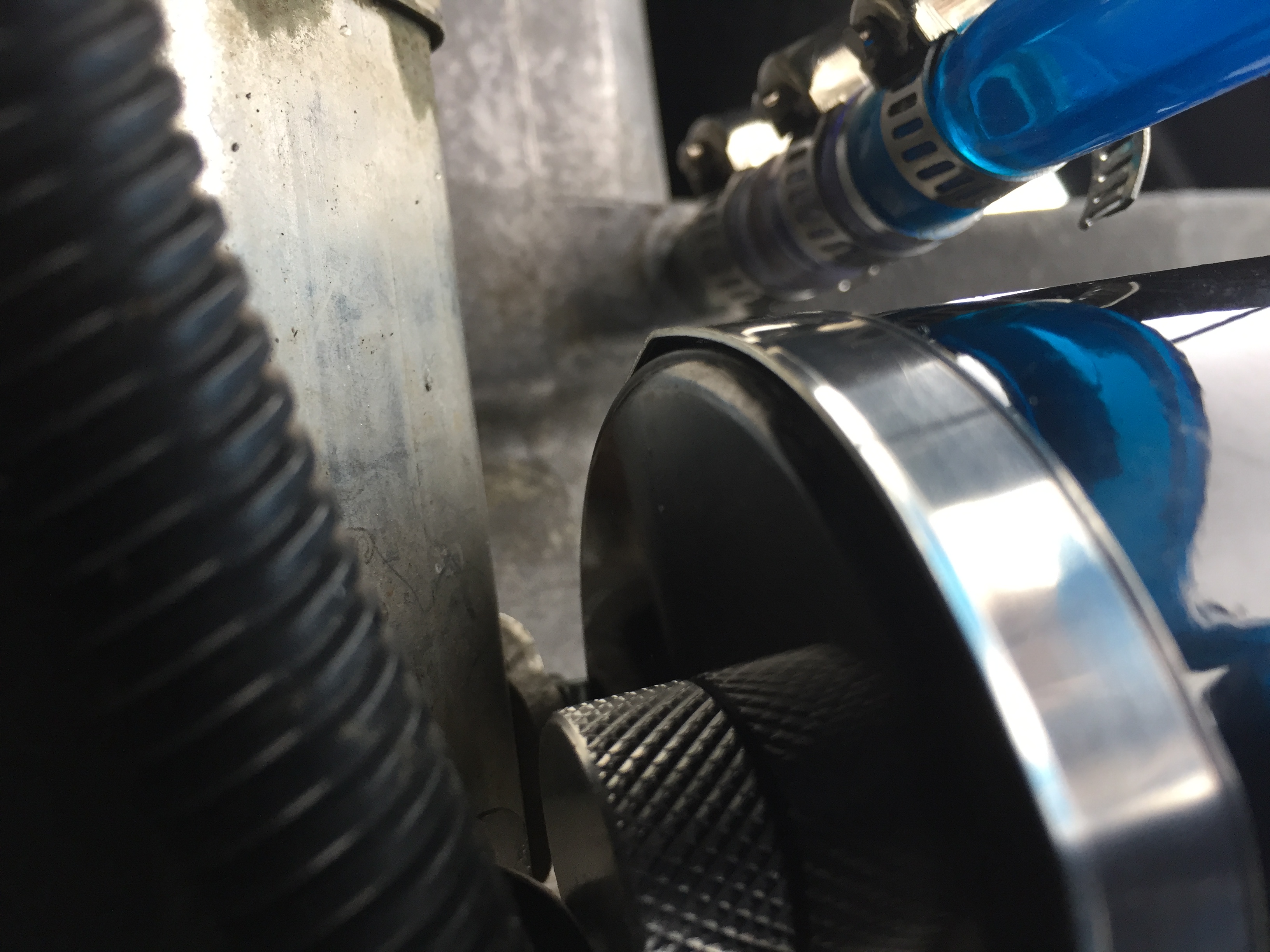

It looks like there's no way to open it for inspection.
Old Jan 26, 2017 | 12:05 PM
Posts: 40,082
There is a threaded and knurled plug on the bottom to drain the tank , 60 miles on this and nothing in it yet!
Attached Thumbnails 2.2 Oil catch can, more of cleaning up then performance!-img_0322.jpg
Good that you used transparent lines. As long as there is no residue on the clean side line, you're good!
Old Jan 26, 2017 | 12:15 PM
Posts: 40,082
That's what I was thinking, and I resisted the urge to use a braided stainless steel hose I have in the parts pile left over from my old show truck. Another angle of the drain plug
