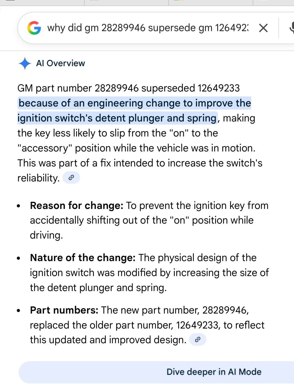

No one should even begin to trust AI yet.
Curious about the (apparently) old updated GM balance chain tensioner, I asked Google, “why did gm 28289946 supersede gm 12649233?”
Then I almost spat out my coffee. The answer was complete nonsense:
I then accepted the invitation for a deeper dive and got something that made more sense. Still vague of course. All ai stuff reads like an unprepared freshman bs’ing their way through an essay question.
