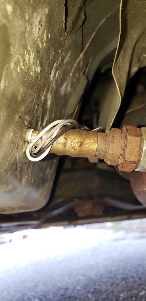

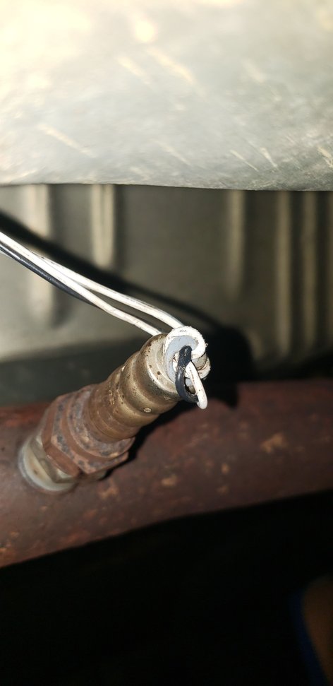

Yeah I'm 90% sure that the wire from the O2 sensor is shorting to the frame. Here are the pics I got.
As you can see the wires are wrapped around a bit and the back end is pushed right up against the frame. This is also assuming that the short is out of sight.

Old Mar 19, 2021 | 06:12 PM
Posts: 26,532
BTW, this is the real answer to "how did you know"? Been there, done that. There are 90 degree adapters, look in the section that has parts for hot rodders that eliminate the cat.

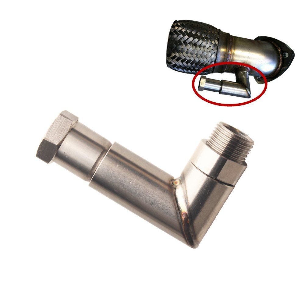

Old Mar 19, 2021 | 07:15 PM
Posts: 40,082
Like this
Just googled 90 degree o2 defouler
Old Mar 19, 2021 | 07:46 PM
Fire_Wessle's Avatar
Joined: 10-27-2020
Posts: 103
From: PA
Oh ok I see. I will definelty look into getting one of those. Either way, I'll still have to get a new O2 sensor ill just run rich without the sparkplug defouler untill I can get one of those 90° defoulers

Just finished replacing the downstream stream O2 senor and EXH fuse #33 and that did the trick! Thanks for all the help guys! This forum is a godsend
The white and black wires had worn through. Although very small bits of wire are exposed, it was enough to short the circuit and blow the fuse.
