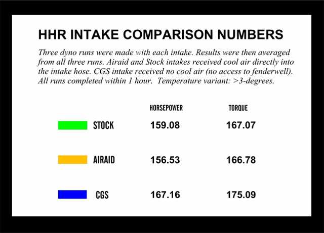

there's lots of stuff for the 2.2L, i guess it really depends on what you're looking for. As you said there is the s/c add-on, i would suggest getting the airaid intake instead of the cgs..cgs seems to only suck hot air back into engine but its your call...cat-back magnaflow or borla exhaust will add more power, headers etc. Are you looking for suspension/steering upgrades or just engine?

ive got the goldline suspension setup and eibach sway bar kit found. and just some info. they dyno tested the cgs vs the air raid the cgs gives you 8 hp the airraid takes away hp

there was another post on here awhile back and it showed the airaid better than the cgs, so i dont know anymore lol. all i know is that i have more power and roar from my engine with the airaid

I guess the posted results would depend on which company performs the test.....

This is true along with the conditions they are tested in.
If people are worried about the CGS taking in "hot" air, then why don't you pull the filter off, attach a flexible hose or tube and stick it in the fenderwell, then add a short piece of pipe to the flex hose and attach the filter to it. You then have your CGS intake taking in "cold" air..... It's really not that hard to get a CGS or AirRaid to take in "cold" air....
