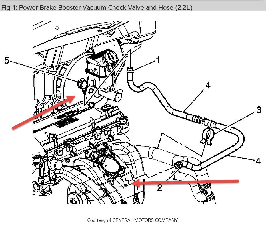

Okay so after digging through the motor I found the line coming from the brake booster head broke off of somewhere does anyone know where that would connect. That kinda vacuum leak would cause all my problems I believe the brake booster side is fine just can't find where it should tie into
Old Jun 30, 2019 | 01:09 PM
Posts: 26,532
To the fitting on the intake manifold.

Ok so a new intake manifold is in store than that's kinda what I thought it tied to thanks for the help guys
Old Jun 30, 2019 | 01:24 PM
Posts: 26,532
I posted a pic while you were typing

I saw that thank you found the leak it's under the right side of the manifold below the last cylinder the spot that the pic shows is slightly different but mine is a panel version plugged the hole with my finger and she leveled off
Old Jun 30, 2019 | 03:53 PM
Posts: 40,082
You can look to see if you could tap the hole and screw in a pipe to hose fitting.
