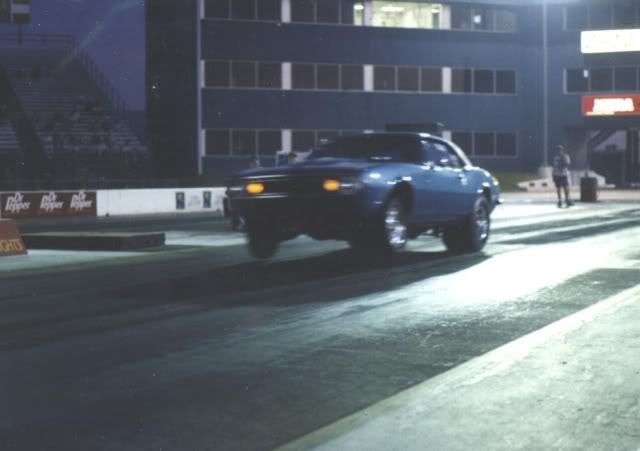

Bigger intake manifold and filter will help, larger exhaust and getting rid of factory muffler will help. Porting and cams will hurt everything below 7000 RPM and you would have to change torque converter, gears and do a tune to get rid of rev limiter to run over 7500 RPM. If you did the porting, cams and tune the gas mileage would be terrible and it would be so loud and expensive to drive you would hate to get any where near it. On my race car I have a 5500 RPM stall convertor because it makes NO horsepower under 4500. None, Nada, Zero, Zip. Do you want a car that you have to have at 8000 RPM just to get out of the driveway?
