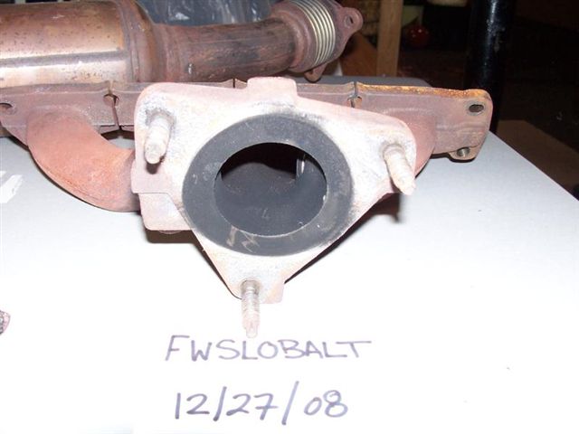

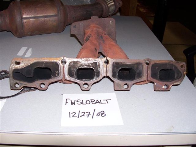

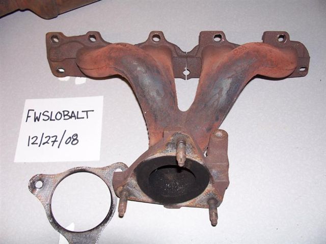

Before you all start buying up ss/sc exhaust manifolds the 2.2 2.4 and the 2.0 ss/sc from 2007 and back are the same header I don`t know if they have different part #`s but in 07 they removed the part #`s off the casting.I have not seen the 08 or 09 cast headers so I can not say what they are like.
In my how too post the picture of the 06 manifold with the O2 sensor in the side of the manifold was a 2.4 engine.They had 5 other 07 engines all 2.4 all the same manifold.Here are 3 pictures of a 2.0 SS/SC factory exhaust manifold you can see in the one picture the threads on the inside.You can also see the big black ring on the flange the opening on the cat side is 80mm on the flange side it is 45mm.
