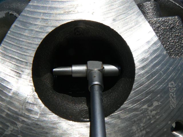

Curly I used my stock 07 2.2 I also have a brand new 06 2.4 they are the same part there are no differences at all.This mod would benifit all the 2.4 owners as they have the same restrictive manifold as the 2.2 engines.

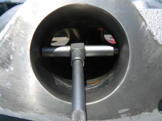

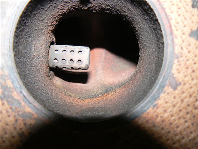

Ok I just dug up some more pic`s
#1st pic 06 2.4 with O2 sensor in manifold
#2nd pic 06 2.4 the inside throat is 45mm the same size as a 2.2
#3rd pic my 07 2.2 ported out to 57mm
