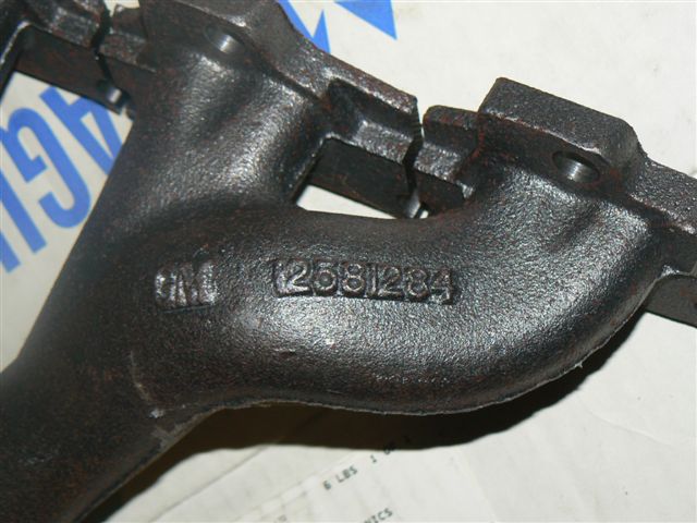

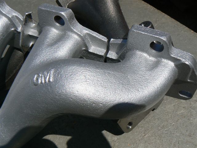

Ok just went out to the shop and dug out a new 2006 2.4 header part #12581284 then went to www.gm-auto-parts.com put in the # and solved the GM header case.
It is the same as the one that came off my 07 2.2 in 07 they removed the part # on the casting.The header comes in a box with the part # on the box GM is just messing with your head.Going back to my old post about saving your self $300.00
and not buying the GMPP header.
It`s just GM running the different parts game they removed the part # so you think there is a difference.This should be called the 2.0 ss/sc 2.2 and 2.4 performance mod as all three would benifit the 2.4 would make the most gains I would think as all 3 engines are trying to push exhaust gases out a small opening.
