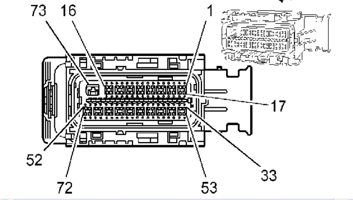

The HHR only has 1 bank and #2 O2 sensor is after the cat. It is responsible for the P0420.
Check the ECM connector, the thing the fuel pressure and fuel level sensors have in common is low ref from the ECM. That is the tan wire on pin #24.
There is a chance that the cat is toast.
Old Jun 26, 2025 | 09:07 AM
Jay12's Avatar
Joined: 06-26-2025
Posts: 24
So I'm not mechanic lol when we say pin 24 we talking about connections at ecm correct?
Old Jun 26, 2025 | 09:31 AM
Posts: 26,532
yes. The ECM is the larger module under the Darth Vader hood.
The top connector:
Number 3 is the ECM:
