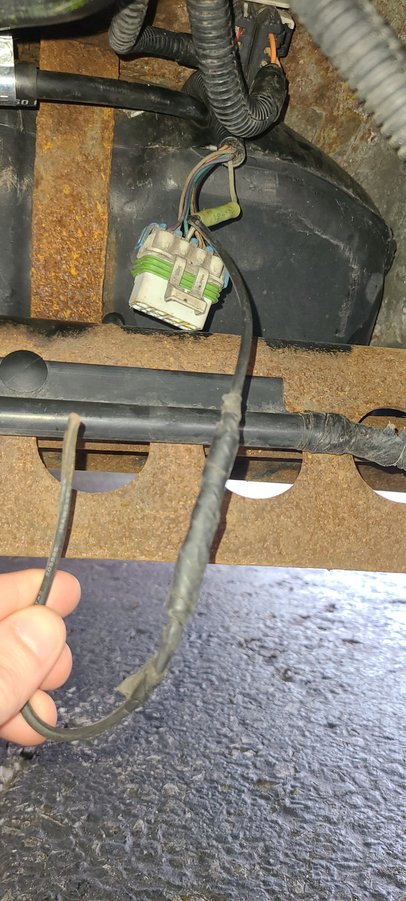

Originally Posted by Jay12
Anyone tell me what this wire for its got connector and another black wire that doesn't go to anything nd not factory
What is that crimp connector? They can corrode and cause trouble, especially when exposed to the elements.
I don't see any wires just hanging.
Old Jun 27, 2025 | 07:04 PM
  #26
RJ_RS_SS_350's Avatar
Joined: 05-01-2014
Posts: 8,511
From: California
That gray wire may have a cut in the insulation just below the butt connector.

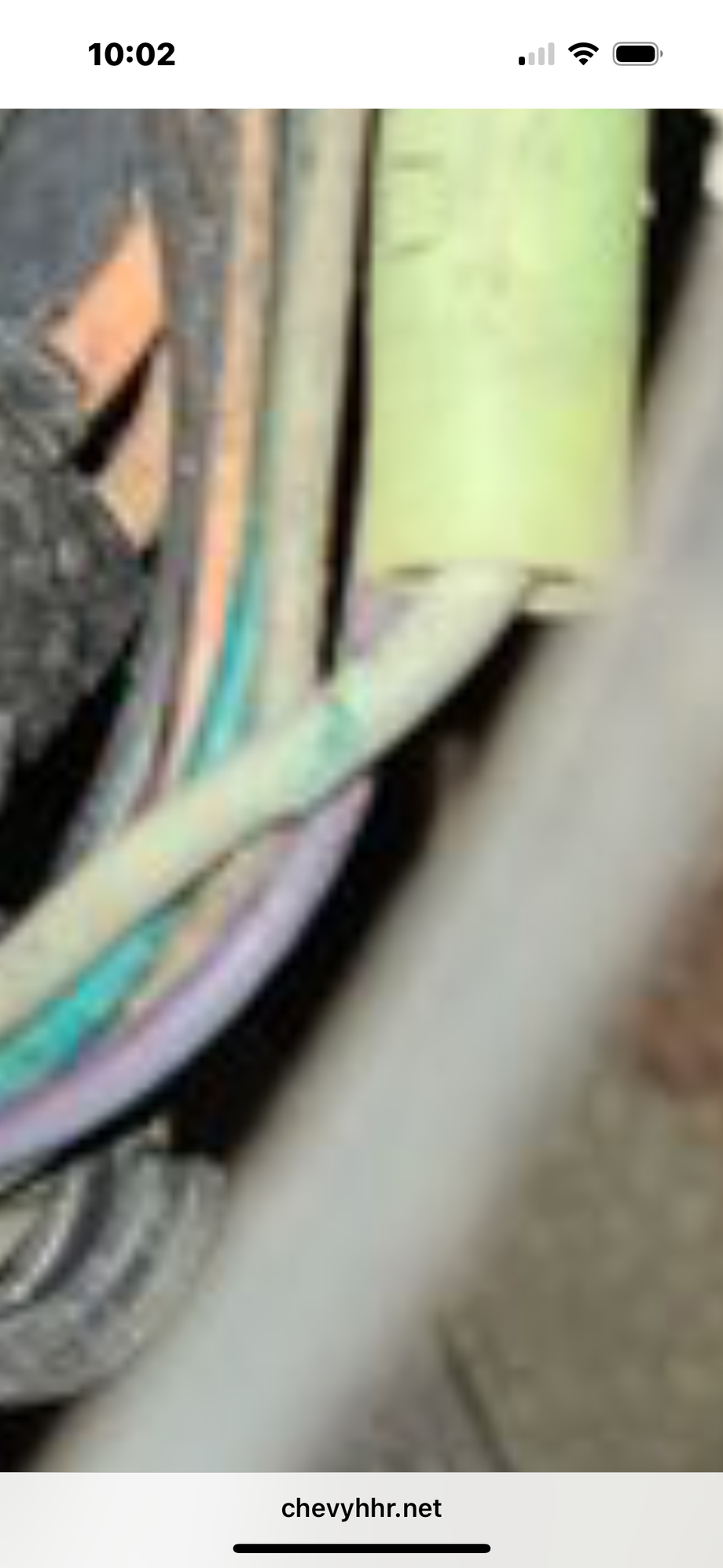

Old Jun 28, 2025 | 09:10 AM
  #27
Posts: 40,082
That does look like a cut in that grey wire . The black larger wire doesn’t look to belong to that harness

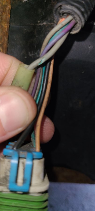

Old Jun 28, 2025 | 09:20 AM
  #29
Jay12's Avatar
Joined: 06-26-2025
Posts: 24
Cut an green on inside
No clue where this was going to
Old Jun 28, 2025 | 02:32 PM
  #30
Posts: 40,082
That wire was added on by a PO who didn’t know what they were doing, maybe a trailer light set up, thought it was a ground or something? It doesn’t belong there.
