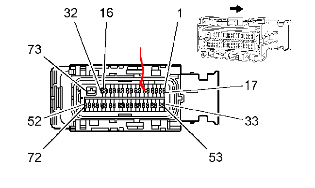

Hello guys,
I am looking for a connection diagram between ECM and 1st cylinder injector in Chevy HHR 2008 2.2L engine. I am facing an issue of lack of steering signal so I need to check which pin from ECM is connected to the steering pin of 1st cylinder injector.
Thanks for your help.

Steering signal ... each Injector have power cable and steering/impulse/signall or however it is named, cable .. how to explaing ? Connection between ECM and Injector . I think it is cable fault and need to see if the cable is not broken .
Old Apr 8, 2020 | 09:51 AM
Must mean "signal". I don't know what good it will do but, it is the tan wire on pin #6 of connector 2.on the ECM.

The problem is the #1 does not work , checked everythink and it stay 2 posibilitys 1. ECM is broke 2. Cable/Connection to Injector is broke. Before i will Check ECM i like to chceck the cable.

I am sure it is cable or ECM , everythink else is check. I need diagram how the injector is connected with ECM , anybody can help pelase ?
Old Apr 8, 2020 | 10:55 AM
Posts: 40,082
As Donbrew shows, in post #5 it’s a tan wire
Similar to this diagram

The color of the cable does not fit .. have someone ECM diagram for 2008 2.2 LS ??
