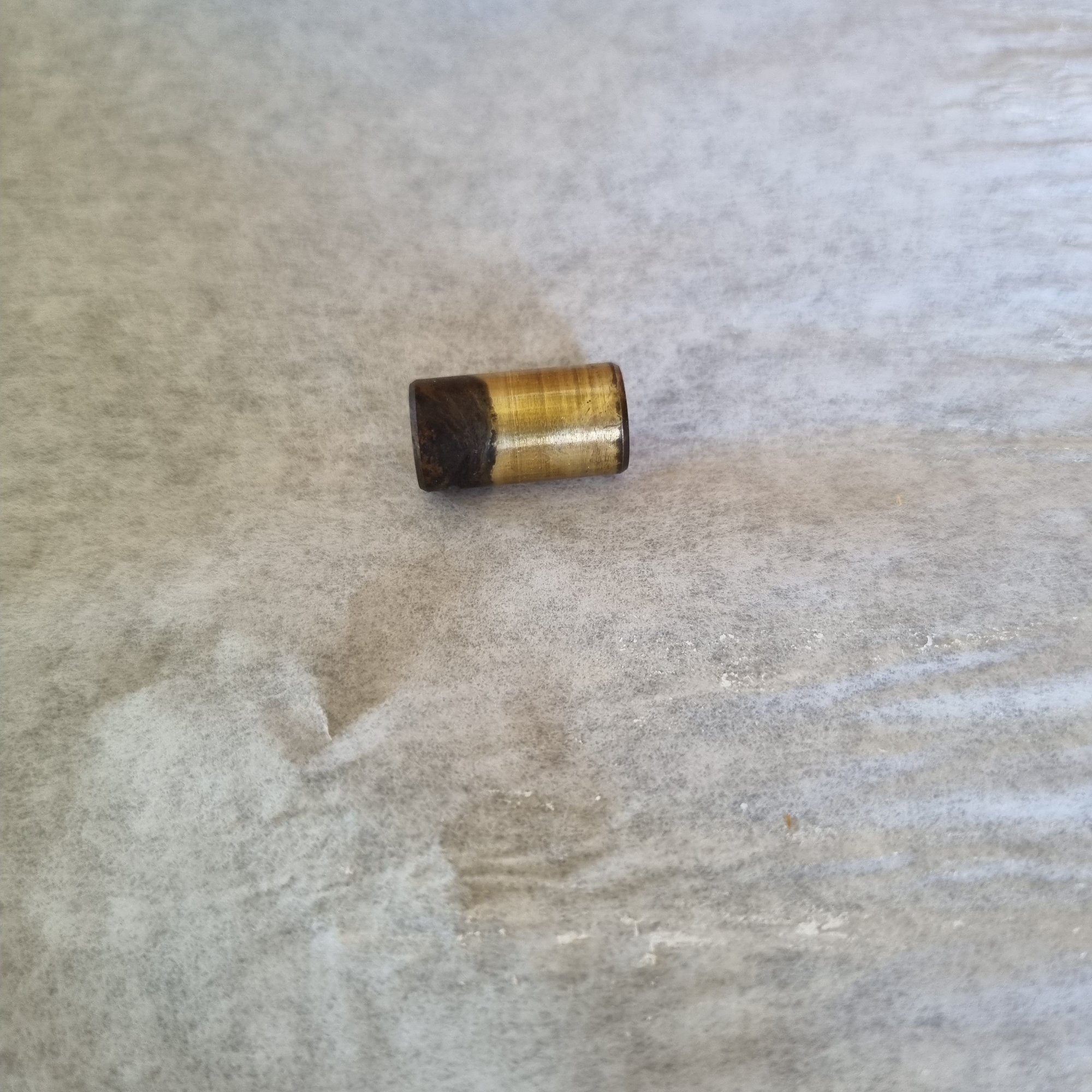

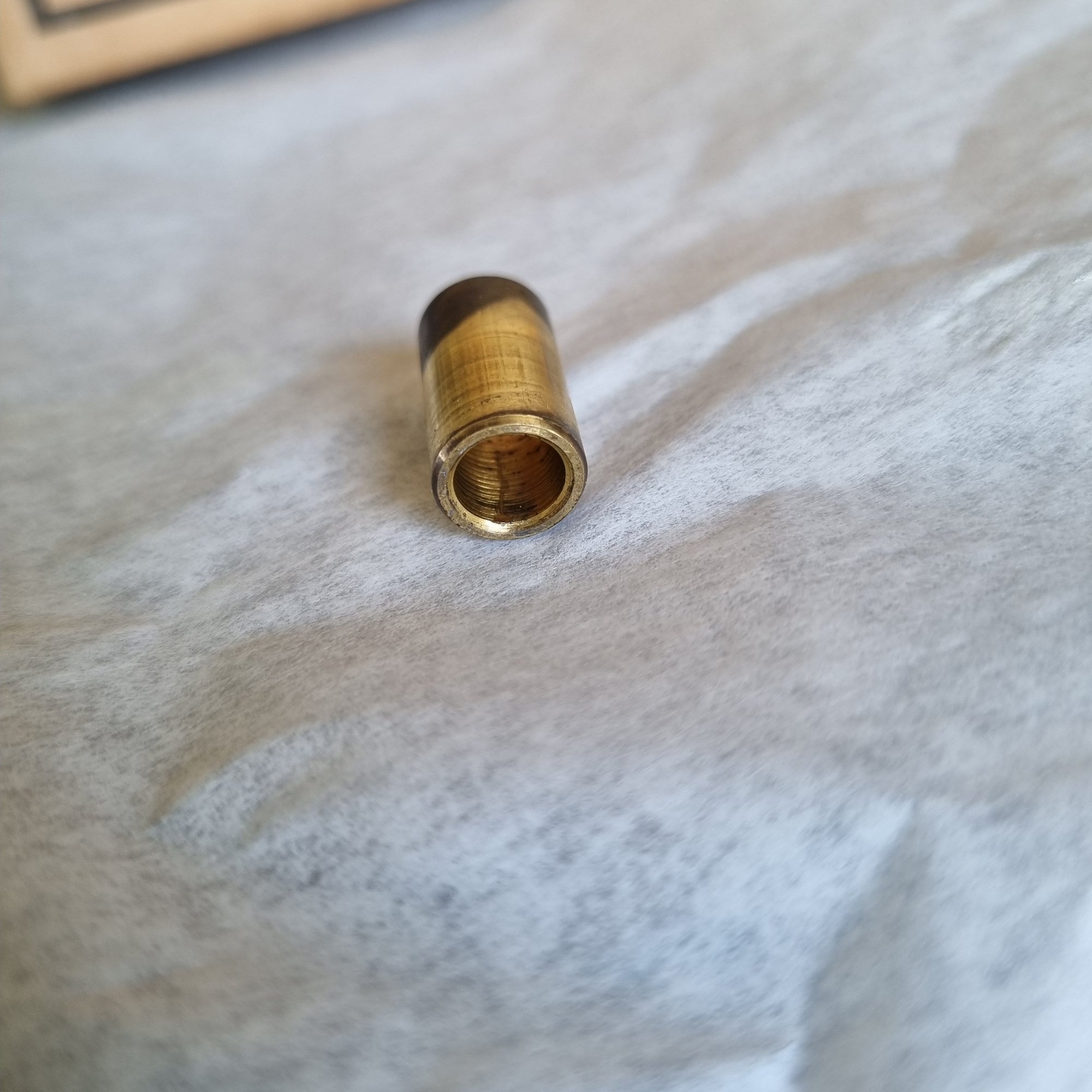

Rebuilt head
I had the head worked, all was good no bent valves but exhaust valves in number 3 where a little leaky. Can anyone tell me where this dowl goes? It roll from under the head when I sat it on the bench.

From: Davison MI
The head has a couple of these that are used to align the head for installation. You should have another that protrudes out of the head unless you lost that one. It goes into the head and into the deck.

From: Oklahoma
There is still the two in in the block [much larger]​​​​​​. I need to check the intake this morning. It was already on the bench. It could be a spacer. I was a little anxious when I pulled the head because I didn't want to lose anything and l didn't see where it came from. I may have missed it when I sat the head down on top of it.

I don’t recognize it from the head or top of the block.
