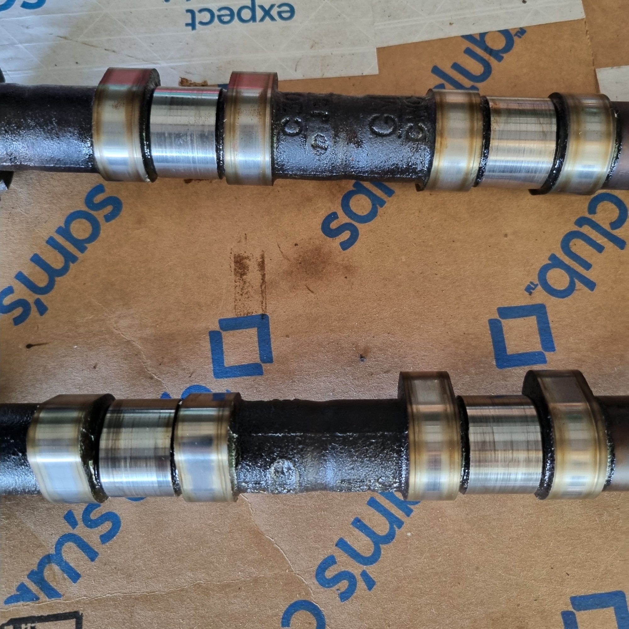

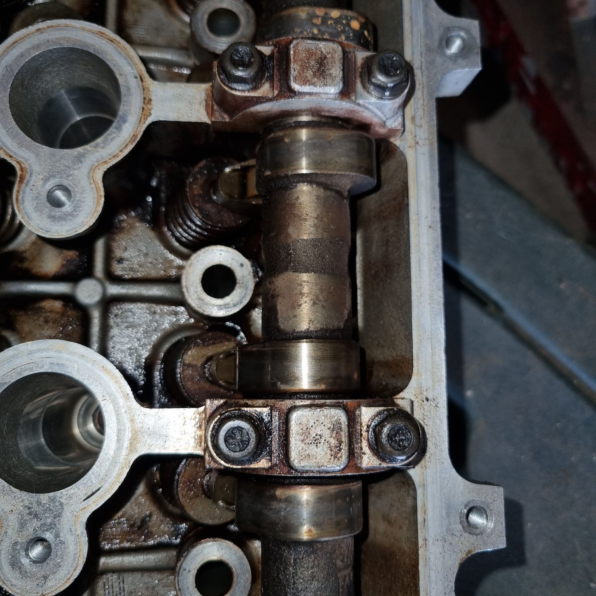

I bought new cams, timiing components and gaskets from Rockauto. They only had one choice for GM cam. I didn't like the wear on the original cams. The motor had over 212k miles on it and did not have the timing chains replaced. I was going to service the engine for Christmas for my son because it was running a little rough.
I found the head gasket was blown. It blew out between 3 and 4 and had notched the head.
l found a 135k mile engine for less the the head work. So I put the new components on the replacement engine. The cams on it where rusty with the same kind of wear pattern.
So the soga began. I never would have dreamt it would not be possible to find replacement cams.
Now I have the head worked because I thought it was possible the valves where bent. All was good but good to know anyway. There some minor rust discoloration where the rings sat but I couldn't feel a groove.
I went this morning and pulled some out of car at LKQ.
I attached pictures of each set of cams. The first is the original, the second of the replacement engine cams and the last of today's picks.

Rust pits are nice oil reservoirs.

I’d install the picked camshafts .

Extra oil capacity on the cams is good but the new used cams are better. I'm going back with them. So much for doing it right with new OEM parts. At this point it's the best I can do.
