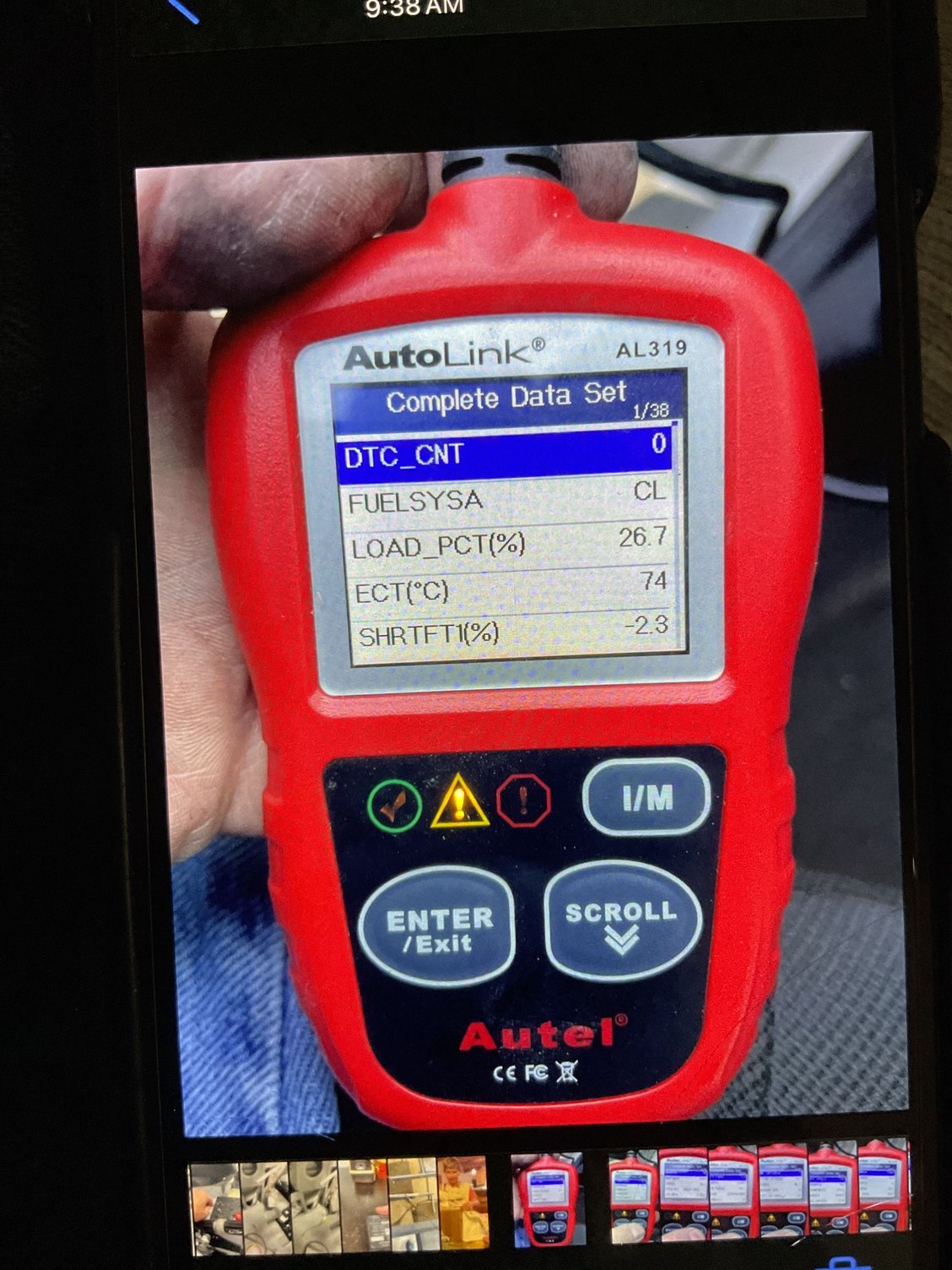

That’s all of the scans.

Have you been clearing the codes? Every time you do that the OBD testing starts over, the EVAP and cat can take 10 days.
Or, the cat is clogged and causing the problem.
Until the O2sensor tests run the computer is in open loop.

Your temps are in Centigrade. I don’t do conversions well. I’m a Fahrenheit guy. 🤔
Is this one of those Canuck Metric HHR’s ?

Originally Posted by Tweetip10
the ALCH is high , maybe Pulpfiction can elaborate
Isn’t 10% normal for ethanol regular gas ?
Most of our gas in the USA is e10, so that seems right.
U0100 lost communication with ECM. You might disconnect the negative battery terminal, then take off the connectors for the ECM, inspect and clean up the connections.

And tighten those 4 bolts in the under hood fuse box
Im not sure about the alcohol percentage, pulp has his finger on the pulse of that
