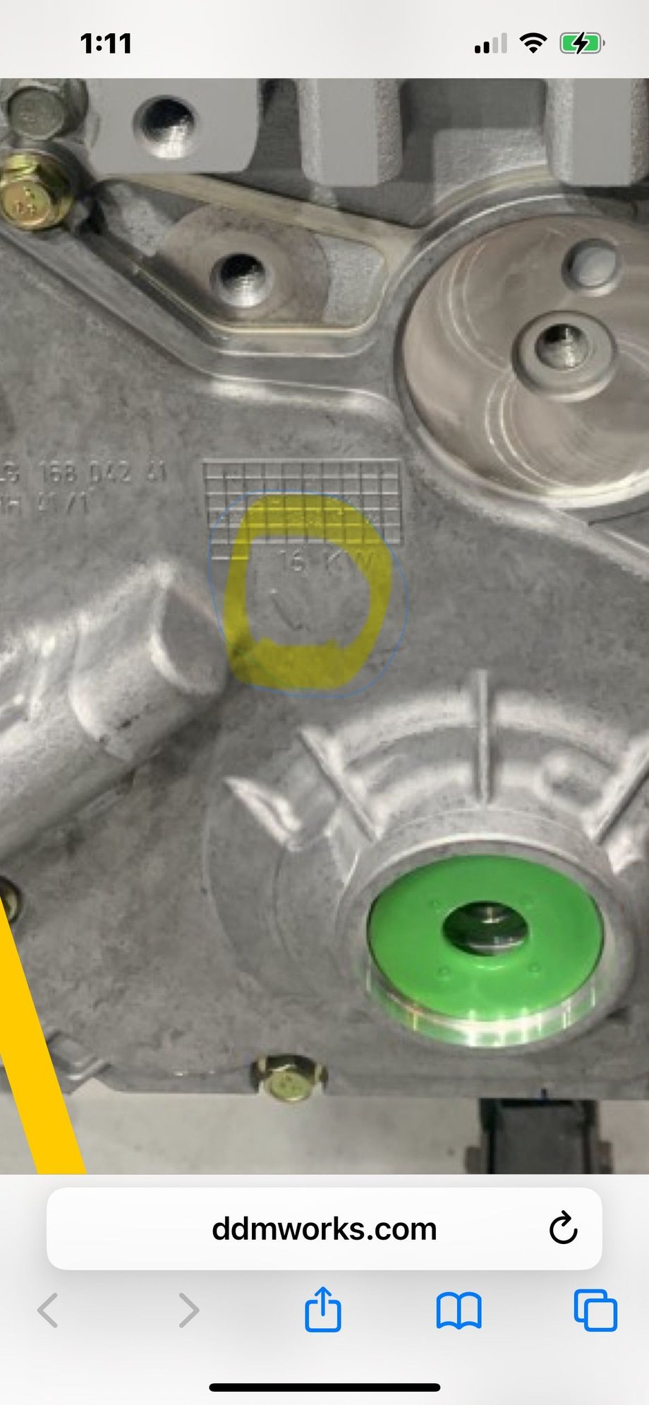

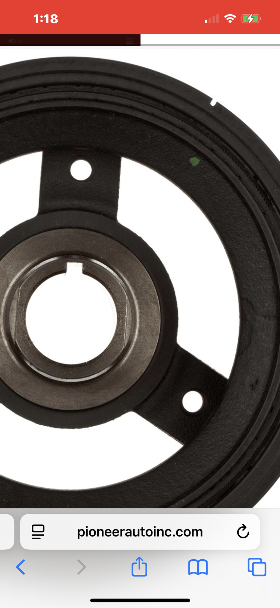

There is a timing mark on the front cover at about 10 to 11 o’clock, you line this up when you turn the crank to get #1 up to TDC of the compression stroke with the notch on the back of the harmonic balancer.
See that white dot? This is the back side of the balancer
This mark, I’ve circled in yellow.
