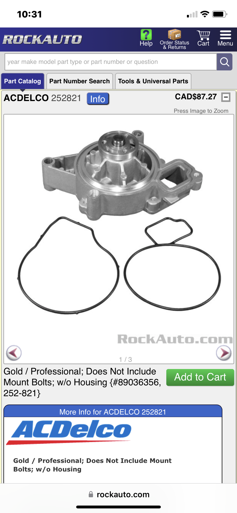

Cloyes 9-4201S and 9-4202S kits, I suggest you change all components as there maybe be damaged teeth on the sprockets. Ensure your 2008 2.2 doesn’t have VVT, prior to ordering!

If I go to the trouble of a re-repair like this , then yes replace the water pump. Get a brand with a metal impeller! Not plastic! To replace just the pump is good, the housing will be fine!
Old Apr 26, 2022 | 09:35 AM
Posts: 40,082
It shows here impeller material … steel!

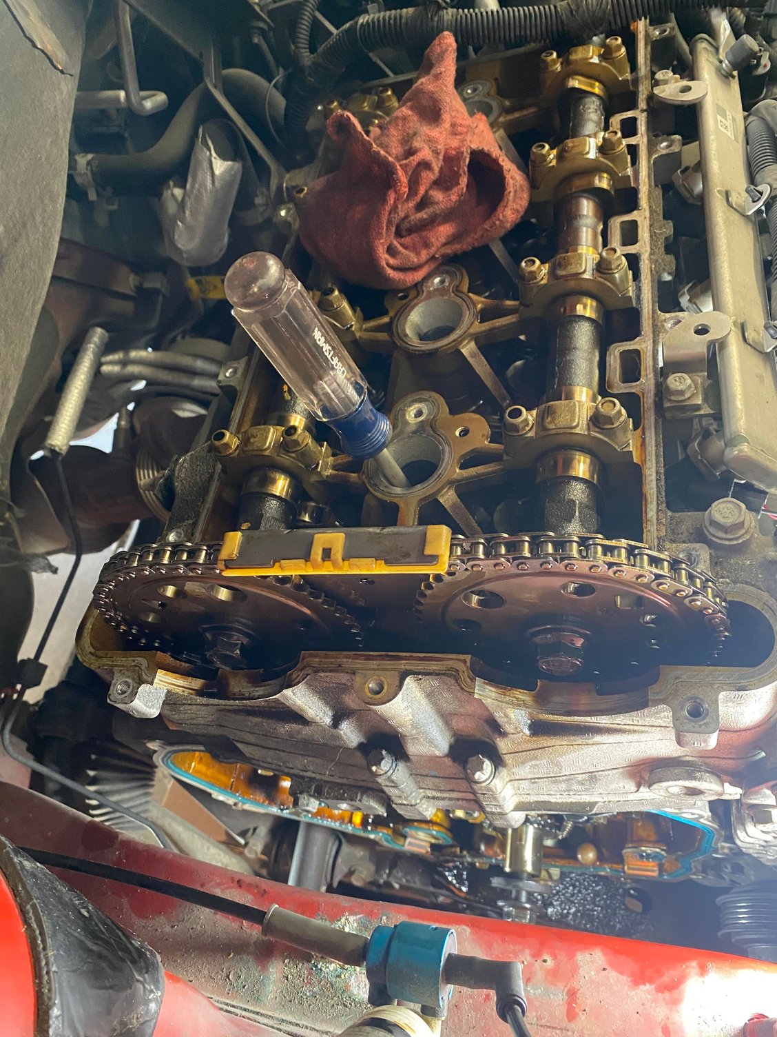

Closest I can get the chain alignment link to line up to the timing marks is 1 link off. I don't remember 2 years ago when doing the job if the chain will slap that top guide when manually turning over or not, but it is now. Every time the crank makes one revolution the chain slaps the top guide. I haven't yet pulled out the guides or tensioners because I'm ordering parts today. I didn't notice any broken guide pieces, but they may be being held in by the top bolt. Going to do the chain kit, balance chain kit and WP at the same time.
It looks to me like my intake cam is the one that's slightly off, that doesn't look like 2 o'clock to me, maybe like 1:30 lol.

Oldblue, are you opposed to the Cloyes kit on rockauto that includes the water pump? It would appear to be a steel impeller inside, based upon the picture. I'm looking for more detailed specs now.

If you turn the engine counter-clockwise the chain will skip.
