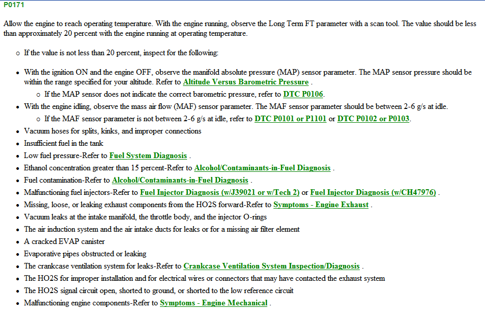

i did this test: " Started the engine, unplug the sensor and drive it" the rough driving and pulling dissapeared, actually drove nicely
Now the CEL comes on with 6 DTC codes when you disconnect it!?
That is what I mean.
BTW, that test would be positive if unplugging it made NO difference in drivability.
Have you bothered to check the other things that were suggested? The flex pipe and EVAP purge valve being the common causes.
Just because the CEL is not on NOW does not mean there is no pending code.
