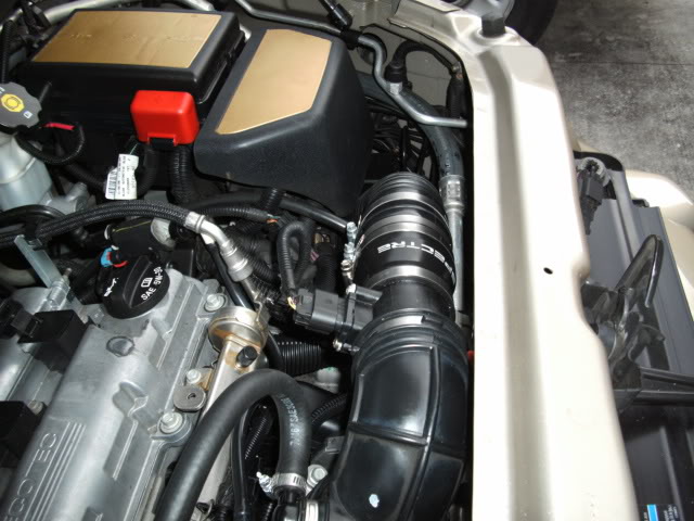

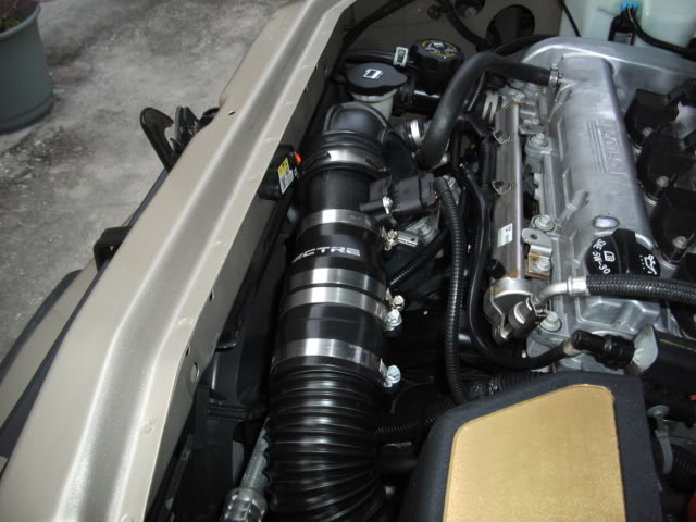

Heres a couple of pics of my setup.The filter is a cone type that sits in the inner fender behind the driver's side headlight,like the Cobalt SS/SC. Got to credit Joe R. and CJ from family.net for the idea. Name:  003-5.jpg

@HHRNole.............. What did you use for the MAF adapter air tube and what diameter is the tube?

I cut the tube off the stock airbox which I believe is 2 1/2". The flex tube 3" is reduced with a Specture reducer. Spectre also makes a MAF kit,with different size inserts. Don't want to go bigger than 2 1/2 on the MAF for the proper air flow. Too big and you throw codes.

That's what I had read about larger tubes throwing codes, and I was thinking about cutting the stock intake for the MAF tube.... thank you for the clarification
