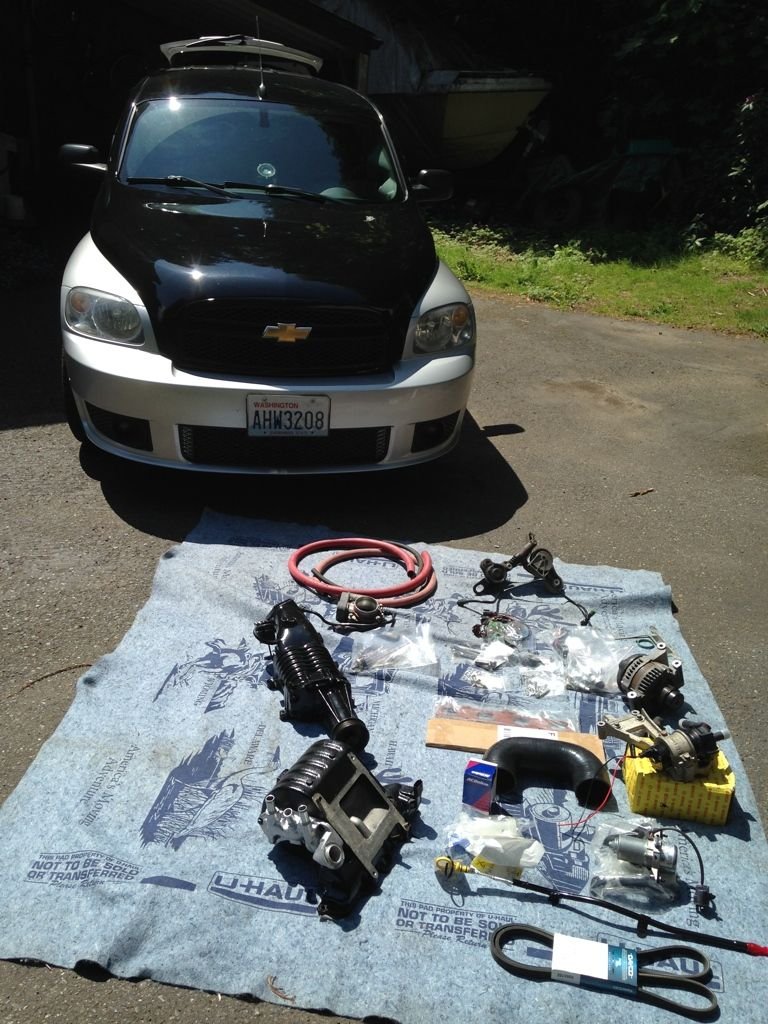

Done it to my HHR. It took a week end. Tight fit. I used my stock 2.2 and added intake, inter cooler, and m61 off a ss Cobalt. I used the stock air cleaner of the 2.2 Had to reprogram the computer. I had done the body work before starting this project.
