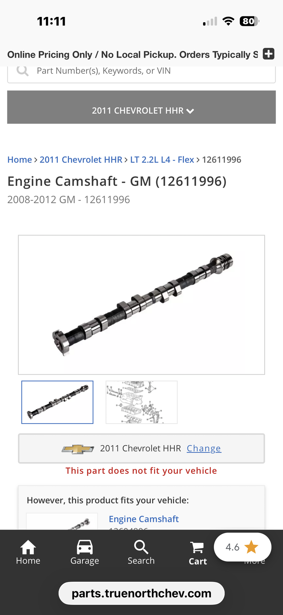

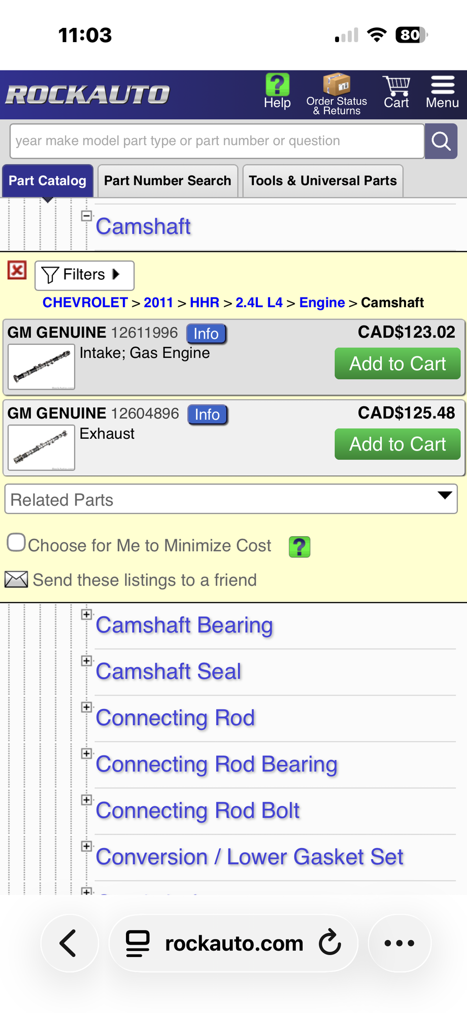

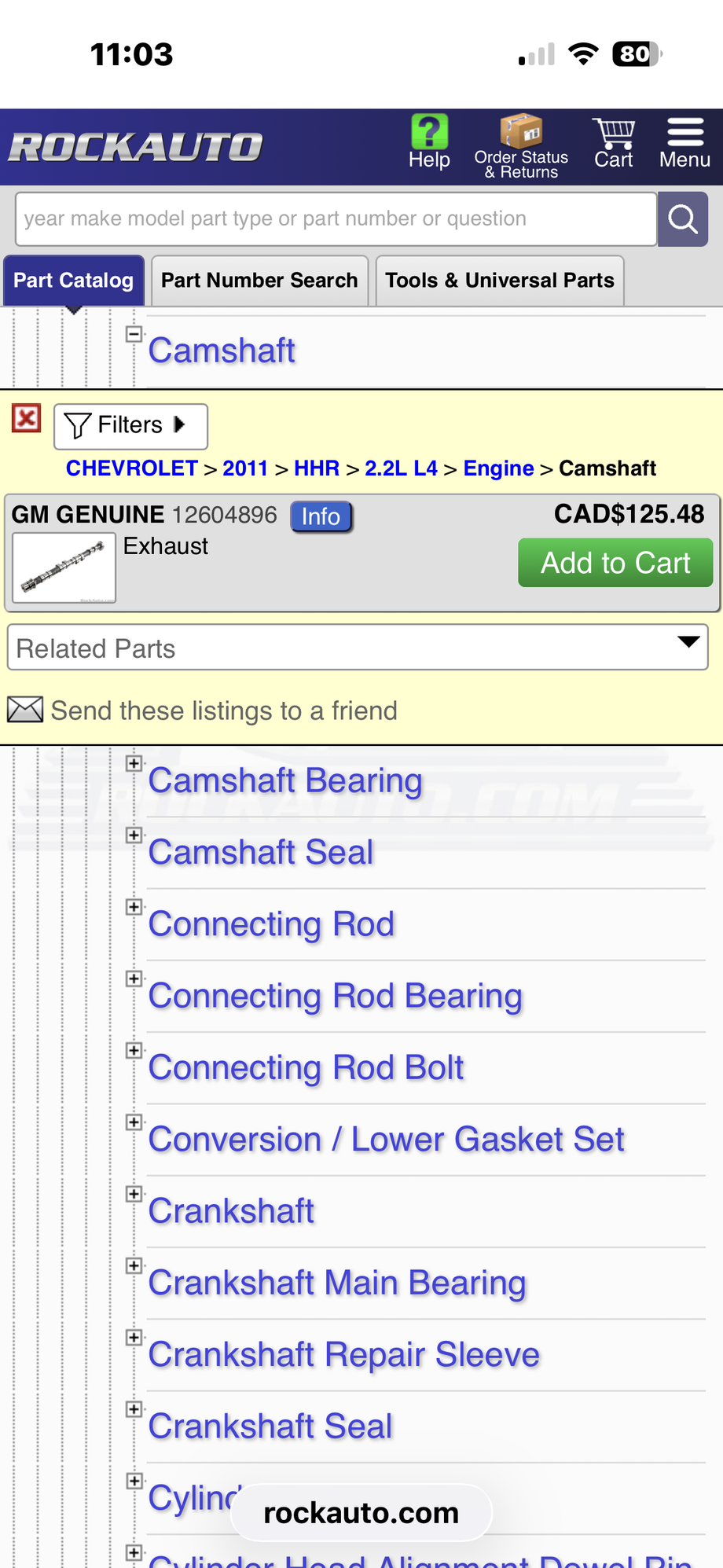

Ok, thanks , I looked at the 2.2 and 2.4 in the RockAuto catalog and the exhaust cam is the same part number but the intake cam doesn’t show in the 2.2 listing.
And here’s confirmation the intake cam doesn’t fit from 2.4 to 2.2
No explanation as to why it won’t fit, I suppose a different lobe grind might be the reason. As you say measuring is important, and sending it back is an option as long as you don’t install it.
