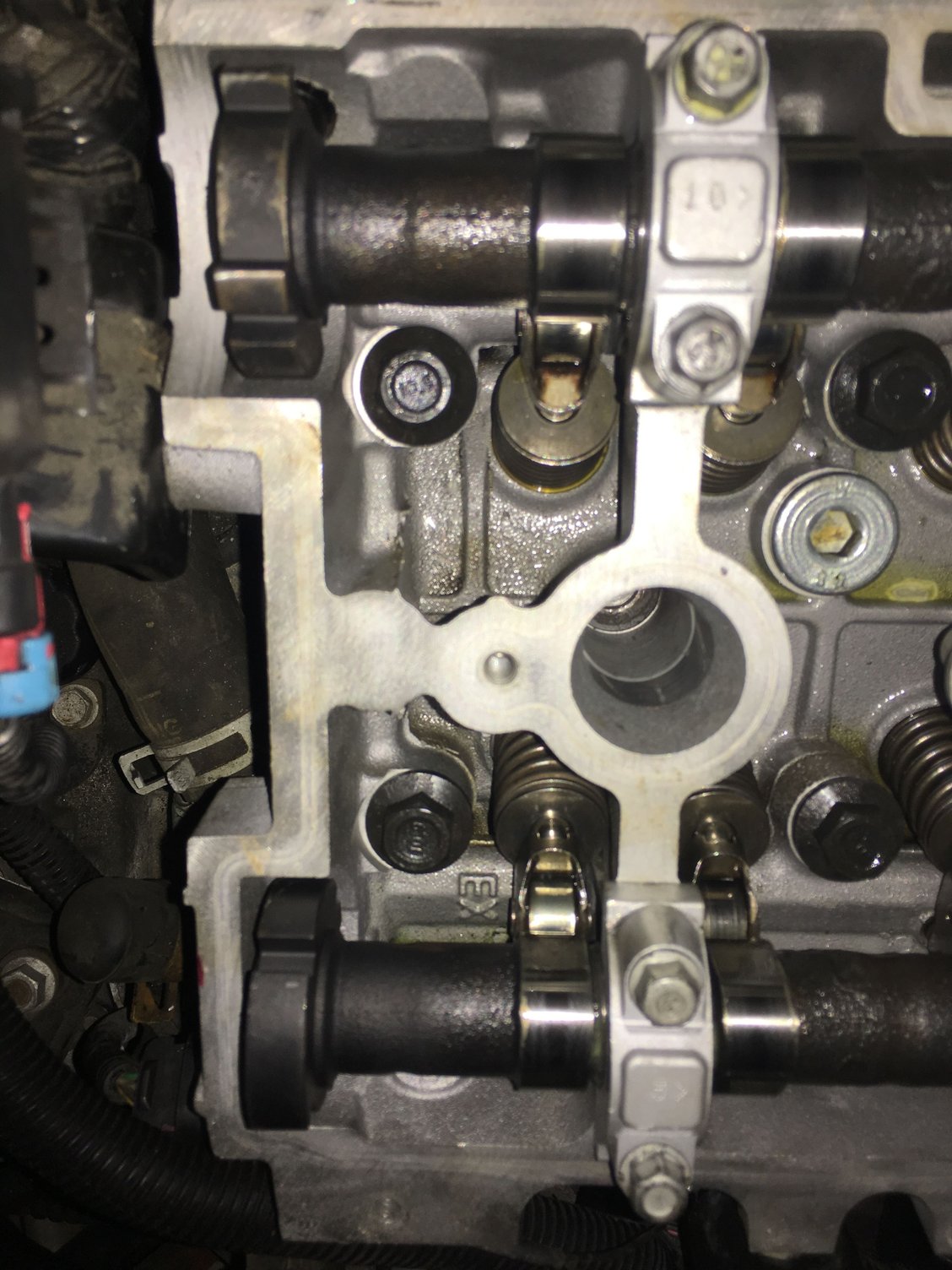

2011 HHR Cams
The way to tell is lay your cams down with the key Cut out at 12:00 and the back end of the cams should look like this picture Note: The Top Cam you see is the Intake Cam and the Bottom being the Exhaust This on a 2.2 VVT engine
Old Oct 14, 2019 | 10:29 AM
  #114
Posts: 40,083
Awesome news, thank you for the update! And verifying how to identify the cams shafts
