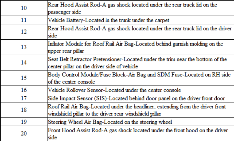

Where are the SIDE air bag impact sensor's located? I usually find them in the B posts on many cars. Are these under the front kick panels? I did find the air bag module under the console area, but still searching for the SIDE air bag impact sensor's. I am assuming two sensor's on this car (or is there more)? Nothing in the dash area blew. Thanks in advance.
Also once the HHR has been T-boned, do I also need to change these sensor's when repairing car? I would assume so. Module has already been cleared of any codes, and new side air bag curtains installed.

Posts: 26,532
This one.
