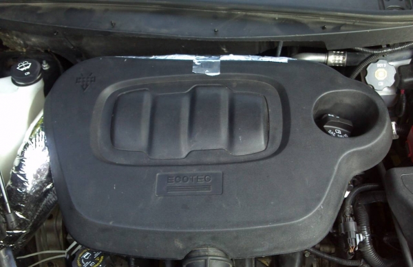

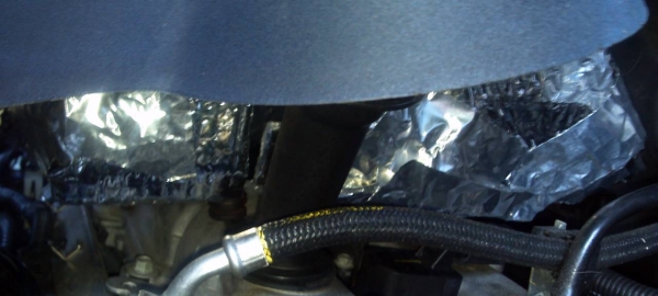

Can you post up a pic?
Old Aug 2, 2012 | 05:44 PM
  #37
prince_bigd's Avatar
Joined: 04-26-2012
Posts: 204
From: Pikeville, ky
Yeah give me a few minutes. I'll go take some quick
Old Aug 2, 2012 | 06:07 PM
  #38
Joined: 04-26-2012
Posts: 204
From: Pikeville, ky
Here you go swerv. If it wasn't for the tape on the top edge you'd never notice it, except on the inlet tube. I just used the double sided tape to hold it in place on the box and between layers, I used two, and then taped the edges down with the metal tape. Today the top if my intake box was the coolest thing in the engine bay, no joke, and it was 95°+ here. It was only slightly warmer after several hours than it was before I started or today just from ambient temps.
