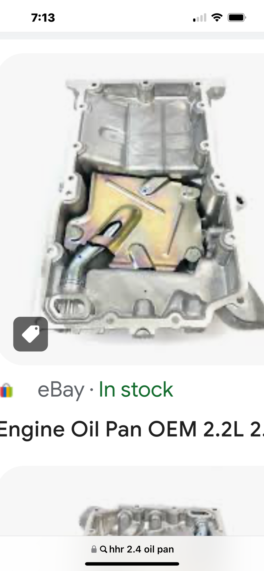

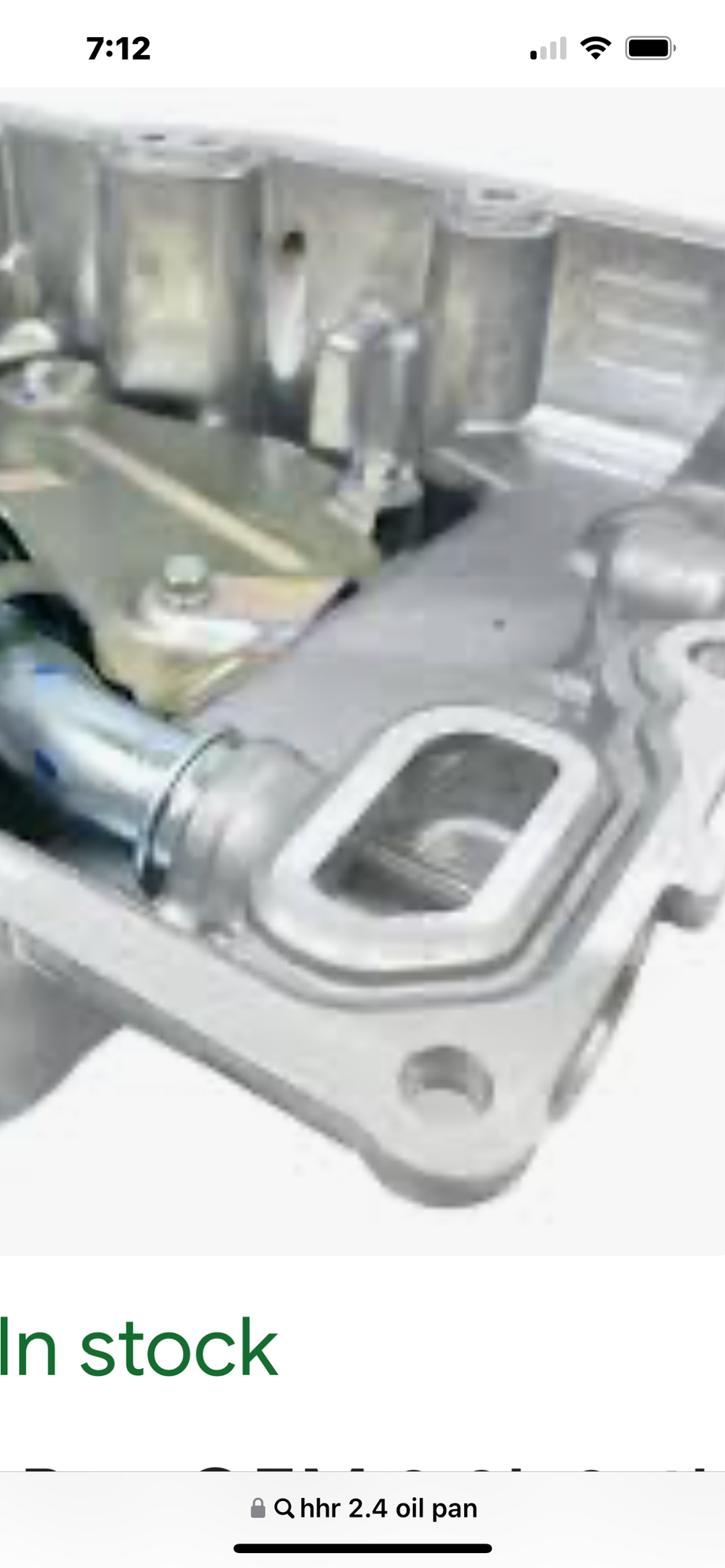

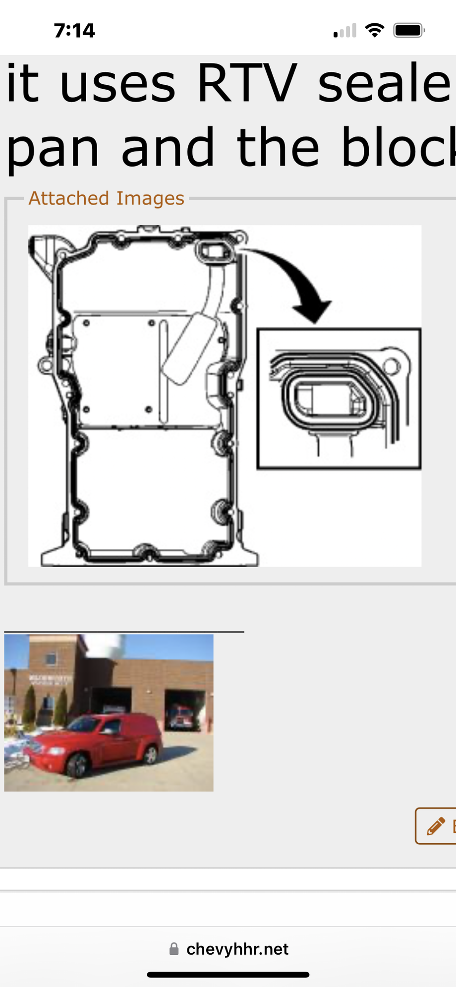

Posts: 40,082
Sounds like you might not have placed sealant on the surface of the oil pan where the oil pump sump is
The oval at the pickup tube
Here is a closer picture
Just a 2 mm bead of sealant is all that’s required
thank you, I'll check
