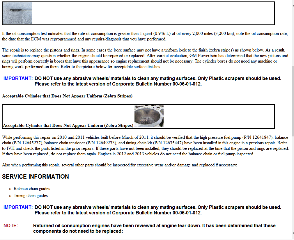

2011 Equinox and GMC Terrain only. You can see the original SB here:

BTW, both LEA & LAF are Direct Injection.
The problem your dealer was having is they have to do the oil consumption test, which means they have to do the oil changes in the shop not the oil change rack. There might be an argument about who is responsible for paying for it or there may have been other mis understandings.

They did not bother to follow the directions in TSB #01-06-01-011. It even tells how much each line means.
