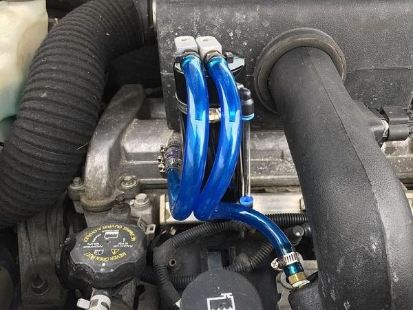

This is my set up in Oldblue, I used the 10 mm / 3/8 inch hose that came with the can kit.

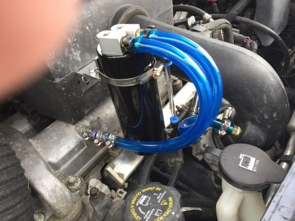

Another view, this was with my old K&N FIPK kit , for the stock air filter box use the other link as a guide to mounting the can

Thank you, that is what I was looking for. Much easier than expected, and now that I see yours clearly, I can see the first post and how the hoses were attached. Sometimes it sucks to get old. :)
