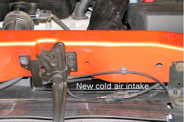

Old Jun 7, 2010 | 02:09 PM
HHorange's Avatar
Joined: 03-07-2008
Posts: 361
From: Essex, Maryland
Or you could just do this..........
Move the air intake to the other side of the box......
add a new "scoop" above the radiator in the high pressure area behind the grill....
True cold air intake, cheap and no cutting a whole in your hood....
for a little better flow add a K+N "stock" filter
And best of all never thrown a code with it...
