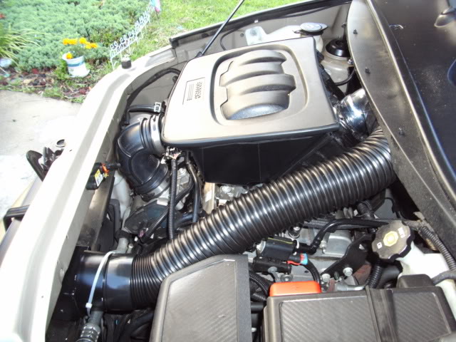

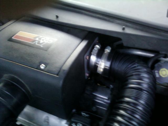

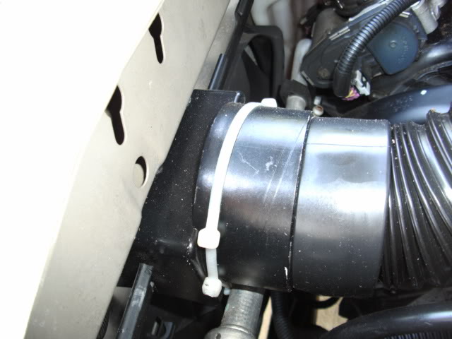

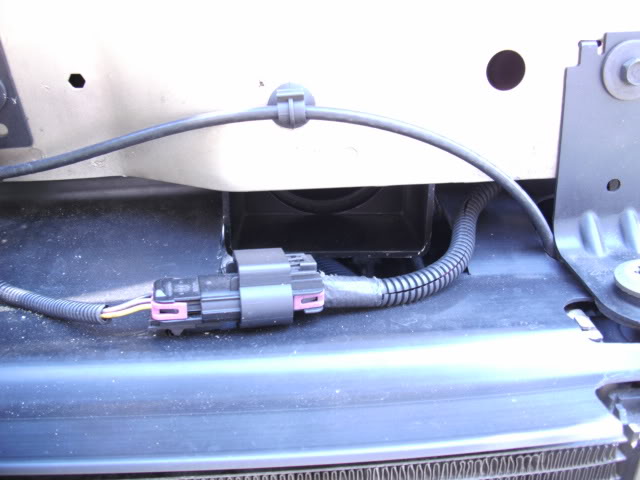

Originally Posted by HHorange
Or you could just do this..........
Move the air intake to the other side of the box......
add a new "scoop" above the radiator in the high pressure area behind the grill....
True cold air intake, cheap and no cutting a whole in your hood....
for a little better flow add a K+N "stock" filter
And best of all never thrown a code with it...
Wonder were that idea came from? Name:  intake003.jpg

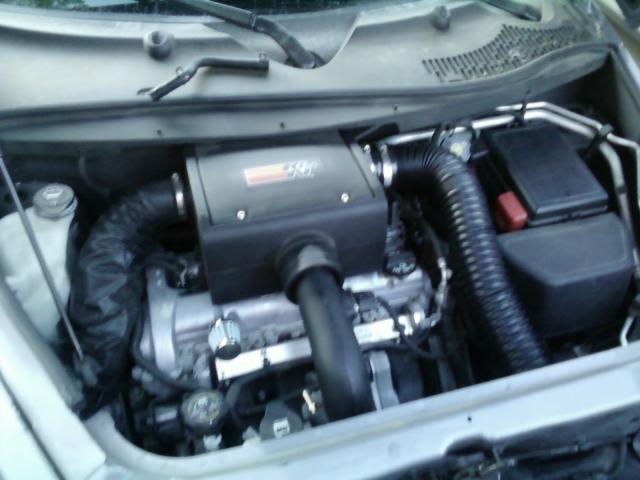

Old Apr 13, 2011 | 10:32 PM
  #39
HHRNole's Avatar
Joined: 08-21-2009
Posts: 228
From: Tallahassee,Fl
This what I have now,filters behind headlight on driver's side.Foglight cover is drilled full of holes to let air in,kinda a still airbox Thanks Joe R. for the idea. Name:  002-19.jpg

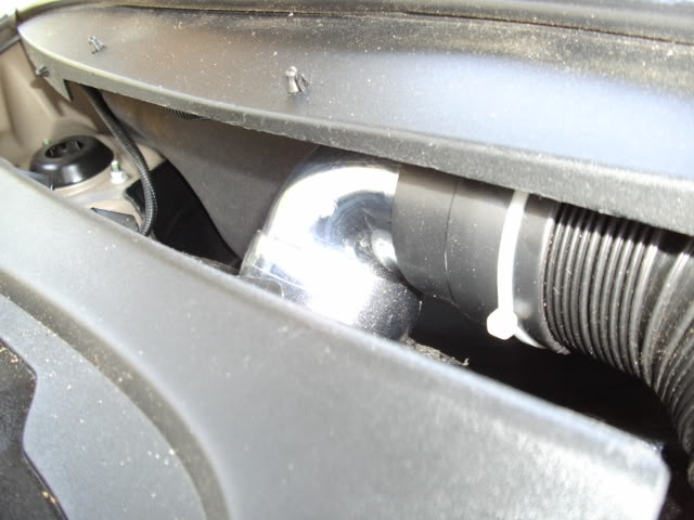

Old Apr 16, 2011 | 11:12 PM
  #40
06gray2ltHHR's Avatar
Joined: 01-28-2008
Posts: 29
From: New Mexico
Ram Air?
It's not exactly "ram air" or my original idea, but here's something that will make your hhr breathe a little better. thanks to the other people who made this modification to their stock airbox that gave me this idea!!
Basically all i did was cut a 3 inch hole in the opposite side of the air box from where the original intake was. i then purchased a 3" intake mount, and a 3" flexible air intake hose, bolted the intake mount onto the side of the air box, and tucked the hose between the radiator and the metal bar going across the top. throw in a few hose clamps and you've got yourself a second cold air intake supply!
I also plugged the hole in the air box where the intake pipe goes into the air box so as to block out any hot air coming into the engine.
