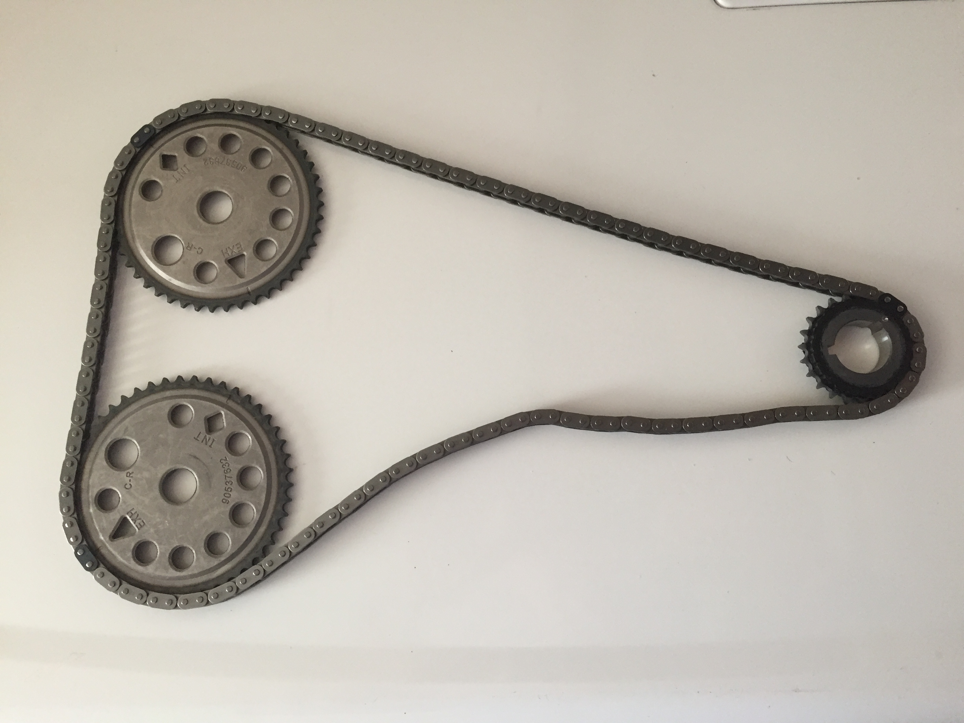

I have a kit a it just has the black links to line up with the marks on the sprockets

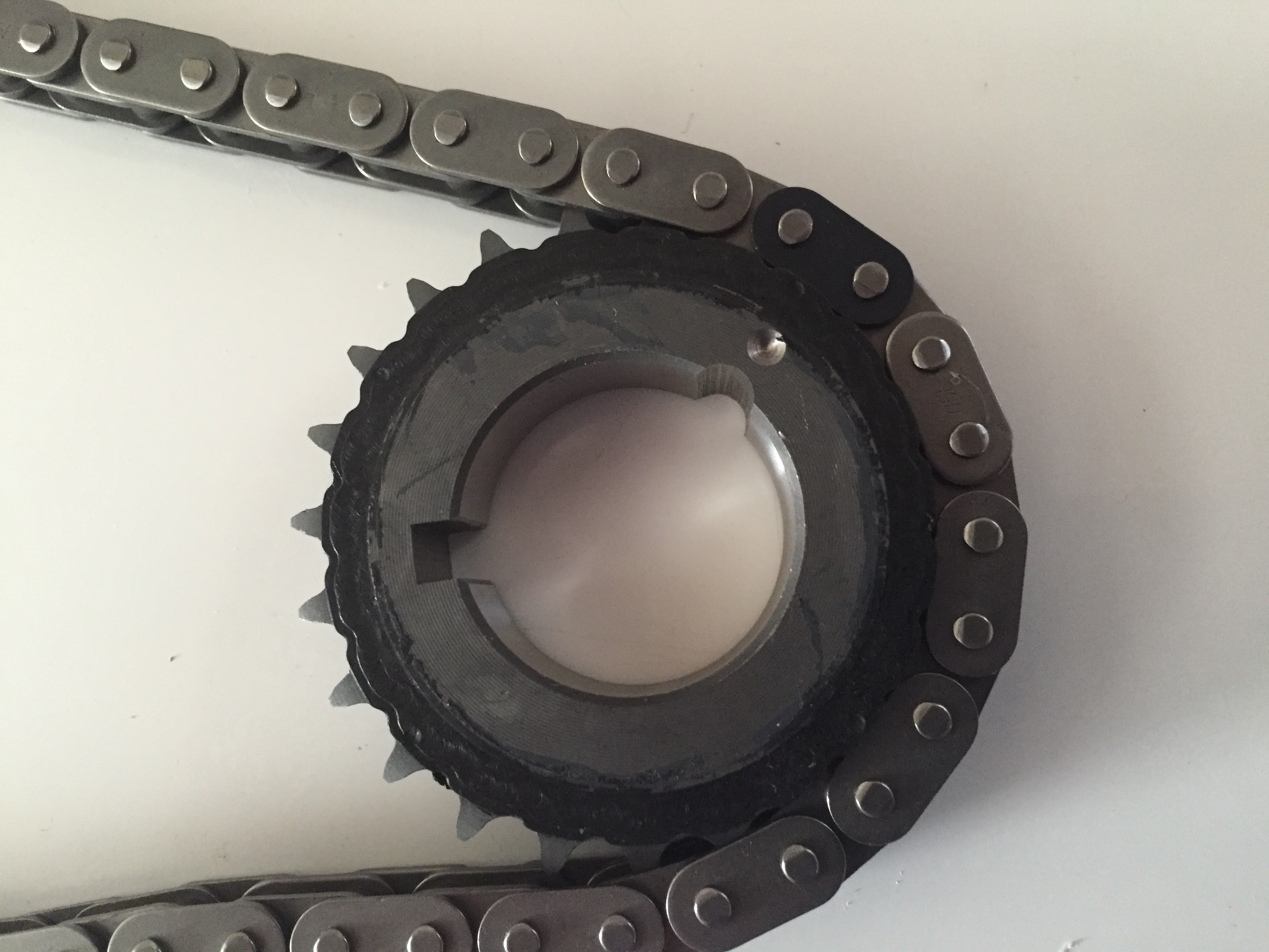

Crank

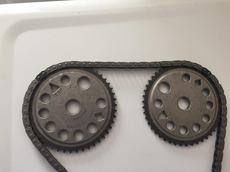

Cam sprockets
