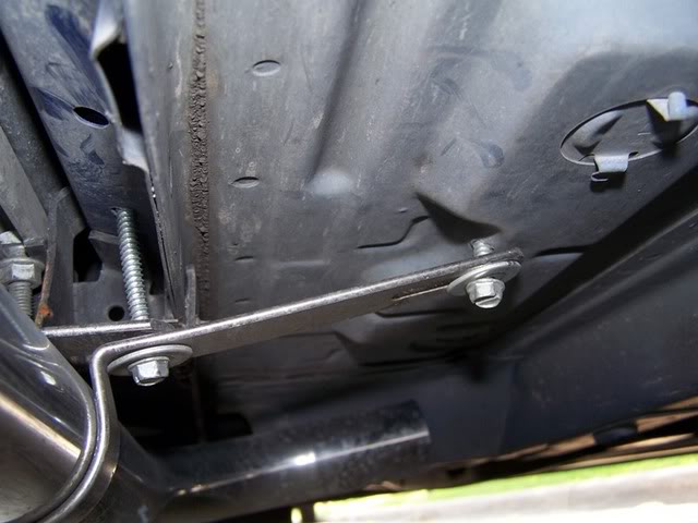

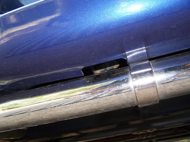

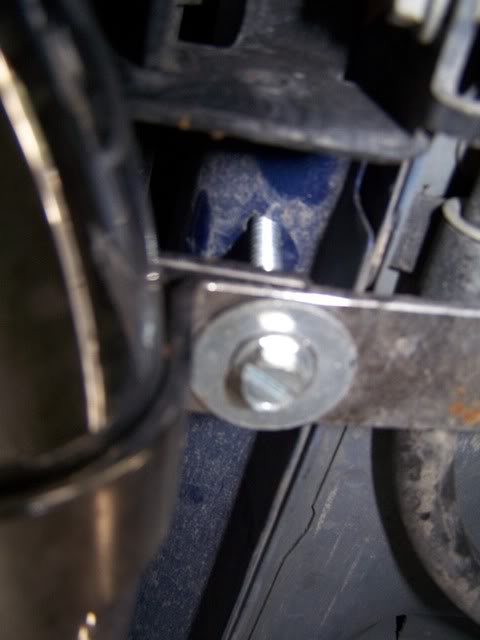

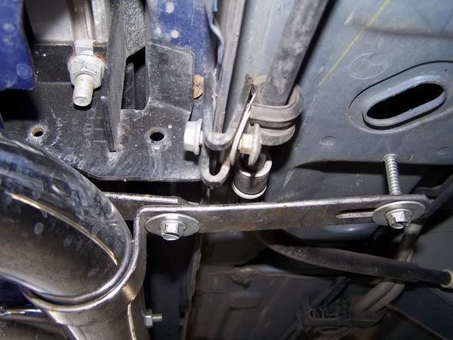

here are pics and how i did my pipe install myself
The car was dirty, sorry, drove in some sprinkler water this morning going to teach.
The pics are labeled and there is an angled wall on the inside where I drilled a small hole and then ran the stovehead bolt up all the way into 2 walls (outer and inner further up the inside) on the outside bolt. The inside bolt just needs a 1.25 to 1.5 in long bolt to go into the body. I just used a drill and drilled the bolts on through.
The placement pic on the front clamp is obvious to the lil rectangular hole on the side and the back one was done around 1 inch from the lil sidewall that goes across that channel under the car on the side.
both sides were the same and the placement worked on both sides. hope this helps
Once you have the washers and bolts and drill small tap holes on the angled wall the install is very very fast. You can loosen the bolts and roll the pipes a little, not a lot.
