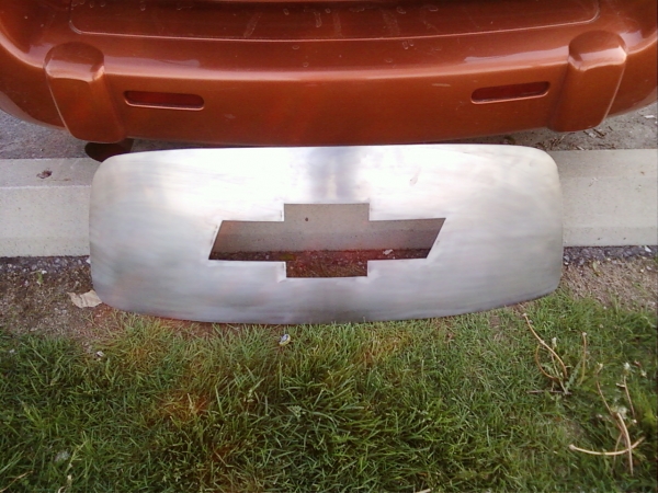

18 guage cold drawn steel...run through an english wheel a few times both directions to give it the same curve as the window(used a repalcement window for template)thanx Carm(APPLE AUTO GLASS)..after considering welding up the back end..I decided instead of making this a permanent thing..made a "window cover"so to speak....to save on time and mess I have had some paint for ol pyro(factory match)canned up in a few rattle cans...I figured Id show a few folks how easy it really can be to achive that great finish on aftermarket parts the easy way.....weather looks good tomorrow for priming and paint..Ill post more as I go...to stick it to the window Im using an acrilic based adhesive..its the same junk that holds your winshield in place so it will hold.....[IMG][/IMG]

Old May 31, 2011 | 08:43 PM
Right On!
Old May 31, 2011 | 08:47 PM
Looks interesting........can't wait to see the final product.

looks awesome

How much for one? I'll buy one!

i know it's only been a few hours, but, IS THE PAINT DRY YET?!
i'll echo Officer by saying "i'll buy one!" too!
X 2, Original thinking outside the box..
Anybody can buy stuff & throw it on.. Making some cool stuff is happening !!!

+1 for using an English wheel! I've heard those things can take off a finger without hesitating...
