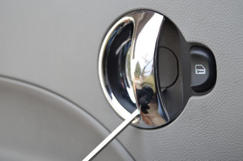

First, let's remove the door panel. You need a T-30 torx bit, a small screw driver, and a panel tool or non marring pry bar etc.

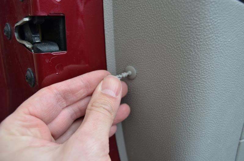

Pry off this little cover and remove the torx screw.

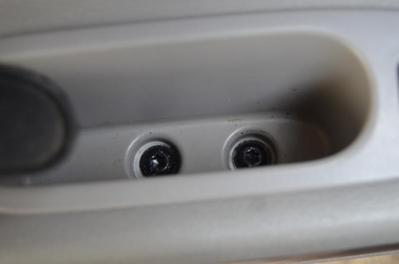

Under the little plastic cover there are two more torx screws.

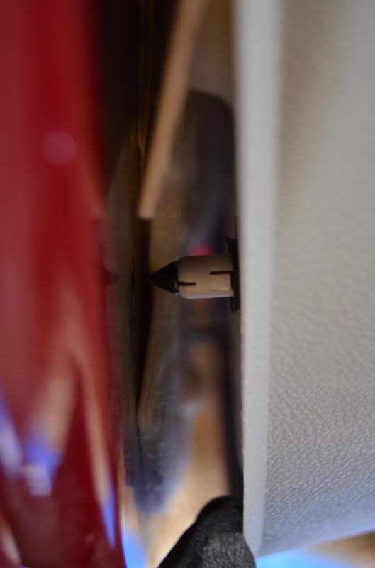

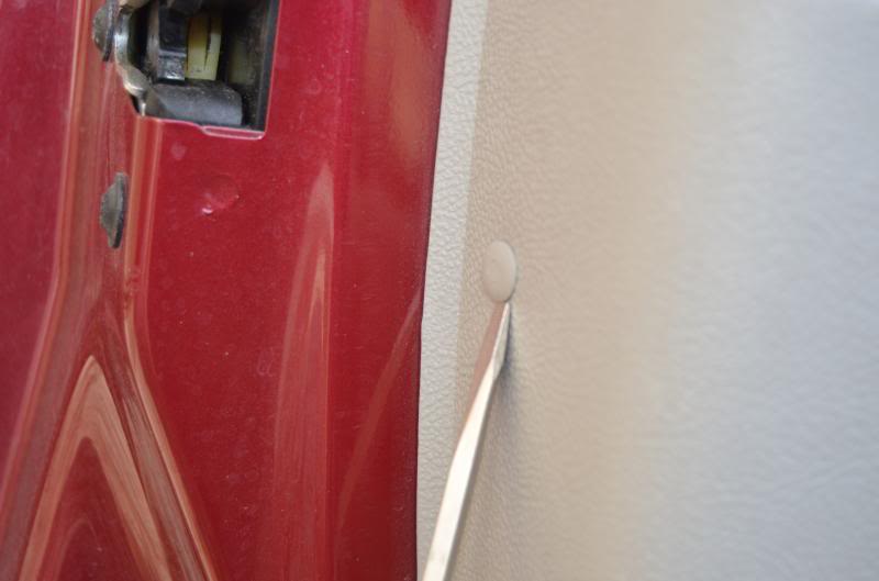

Pry this little plastic rivet all the way out.
Start working out the panel fasteners. Some may come out with the grommets like this one did. I separated them once out before reinstalling.

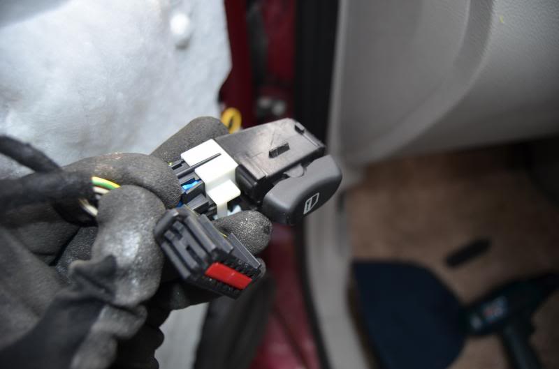

These three parts (two parts on all doors besides drivers) must be carefully detached. The first pic is of them still attached and the second is detached, showing where they attach/detach. The door handle cable is a simple removal at this time as well.

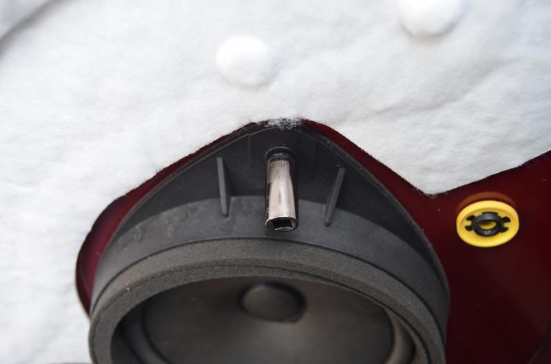

A 7mm socket worked to remove the screw holding the speaker in.

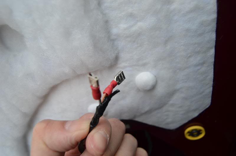

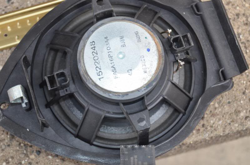

Speaker is out, I cut the wires because I am not reusing the little harness. Now I cut out all the little supports that hold the speaker in place using a multi tool, a think a hack saw would work. Probably a few ways to skin this cat.

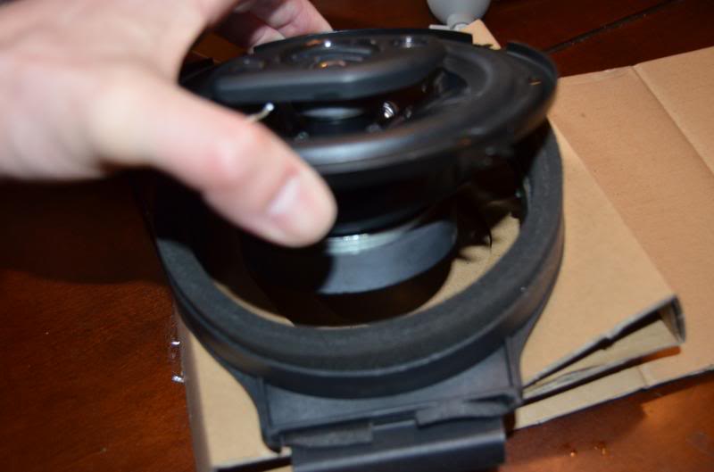

Speaker is removed from housing.

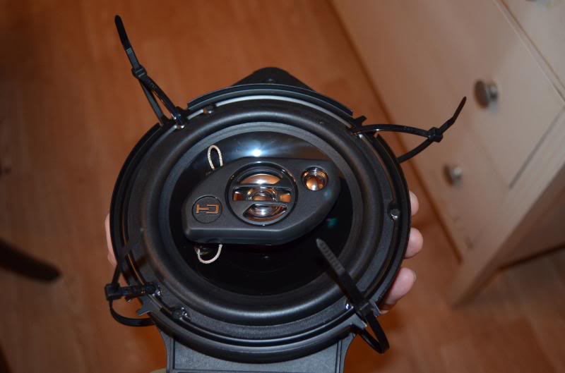

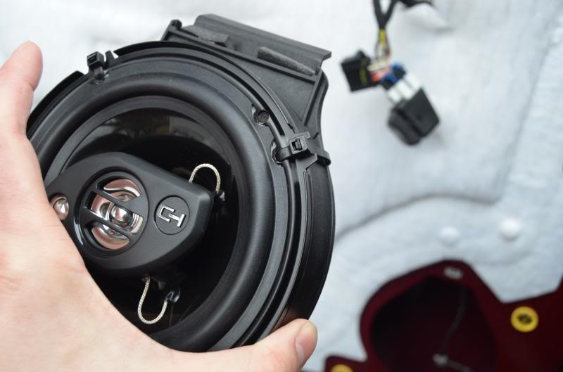

My new cheapo speaker from Walmart fit perfectly in the opening. I left the foam ring in for a little vibration dampening.
Zip ties from that I had on hand.
Zip ties tightened and snipped off.
