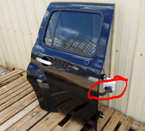

This is the best pic I could find. The harness plugs in on both ends, I think.

That harness looks clean, dry and free from corrosion. Without taking the door off, I've got no way to look further. Is there something I should be looking for there?
Something I didn't think of before: I can open the other windows from the driver door but cannot close them. The locks operate normally from both doors.
