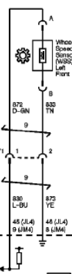

I am a bit confused; the description in the book says:
But the wiring diagram shows Low Ref and Signal are the 2 wires. Low Ref is usually 0 - 3.3 V, mostly 0 volts because it is easier to do.
I’m not saying that’s wrong but could you clarify why you think that’s inconsistent? I think if the sensor just alternates from low to high resistance, the voltage at the wire on the left will alternate two values, which will depend on the two resistance values of the sensor, and the value of the resistor on the bottom left.I’m assuming the that there’s 12V on the other side of that resistor, and that would be the 12V to which the description refers. That seems consistent with the description.
I think that ground needs to be checked along its entire length, maybe just make sure the resistance is very low between the pin and the frame.
