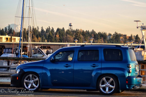

heres mine

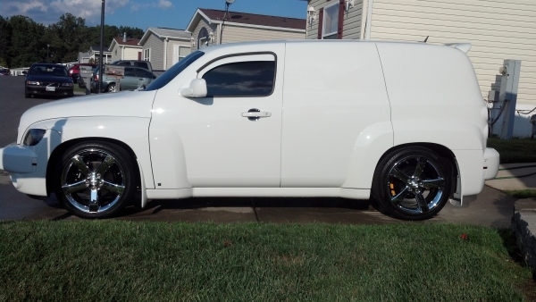

Old Mar 7, 2013 | 07:21 PM
Looks good Capp, heres mine.
I installed two sets of YYZ's today, V1's and V2's both are sweet.
