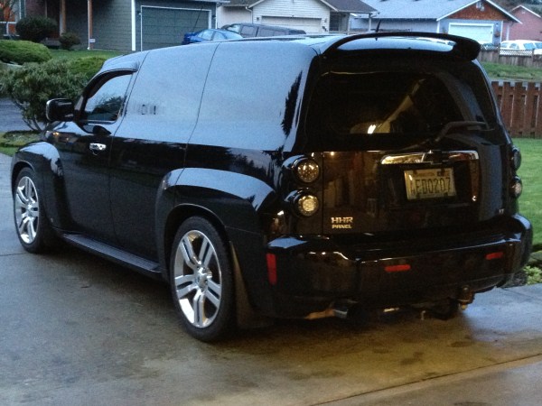

I put new canuck motorsports rear springs in my 09 panel one week ago.I've put on about 80 miles and so far only one inch of drop. Was told they would give me 2 inches in the rear,not enough time to settle in yet? Can anyone tell me of their experiences ?

Thanks for the input,checked my work and found no problems with fitment. I am running 215 55 16s for winter,and measure 26 7/8 inches to the wheelwell on center of wheel.How does this compare with anyone else?I have a black panel just like the one in my replys. Being an old school type of guy,build hotrods & harleys...this is my first foray into a front wheel drive. Gotta say this site has been a hell of a help,thanks.

You have great taste in Panels...........
